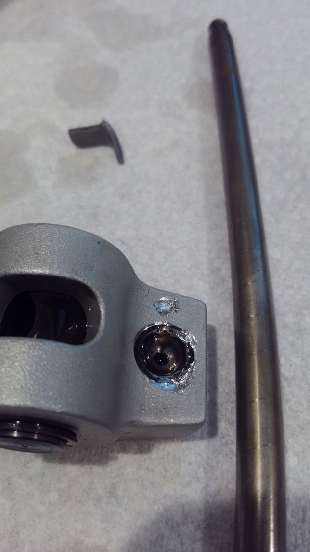

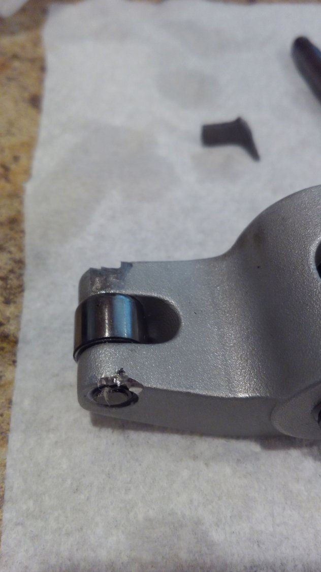

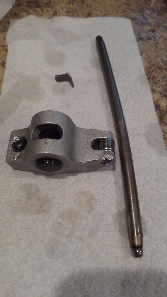

#5 Exhaust rocker off the valve
#5 Exhaust pushrod bent
#5 guide plate broken
SB gets the golden ear trophy
Pics coming momentarily

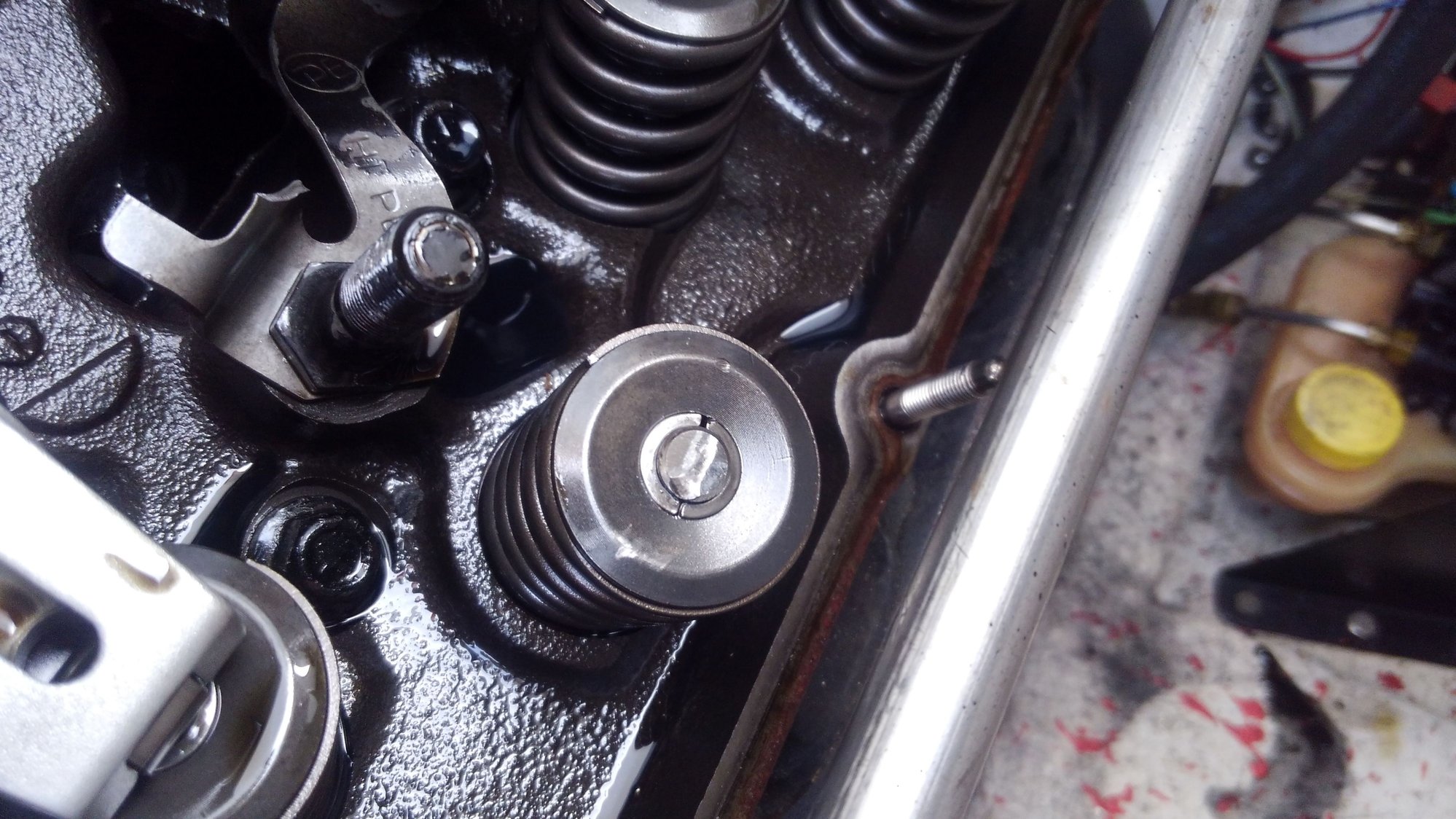

Yep.

The top of that valve took a hard hit and now may be bent and hung open as well.

that doesn't explain what killed the plug, there's some debris loose in that hole,

I just borrowed a cheap usb borescope from a buddy, didn't really see much. saw some clean areas of the piston at the outer periphery, possibly consistent with the rich burn that was occurring.
I guess my big question at this point: Was this a coincidence, happening right as I began to feed a tiny amount of water in the intake, or did I cause this? And if I caused it, how?
