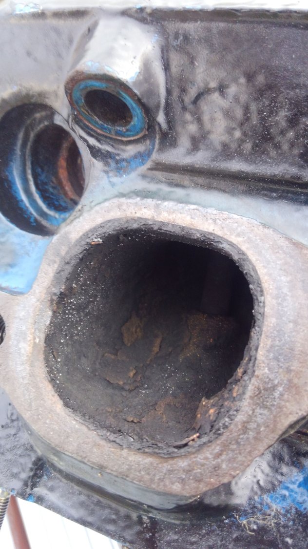

Originally Posted by TomZ
Is part of the seat torn?
I don't think so. It looks clean but not physically damaged. My guess is maybe that's the point where carbon got squeezed by the valve?

No sign of any header leakage with pressurization and heat...
Previous owner pulled the port header off the port motor, to replace a trim pump motor, when he reassembled he did NOT use a tailpipe gasket, instead just slathered red RTV all over the joint. Based on the soot and water on the inside of the v-band clamp, there was likely leakage at that tailpipe joint, leading to a risk of reversion. With #5 and 7 being the cylinders closest in proximity to that source of water via reversion, I think that's what led to the rusty exhaust ports on those cylinders, and the increased carbon found in those combustion chambers likely due to this as well.
No rusty exhaust ports elsewhere on either engine.
I still think I'm going to sell these CMIs and go with a set of Stainless Marine manifolds since I am a salt water boater. Eickert manifolds are NLA with no date of being available again at this time.
