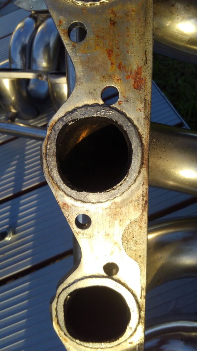

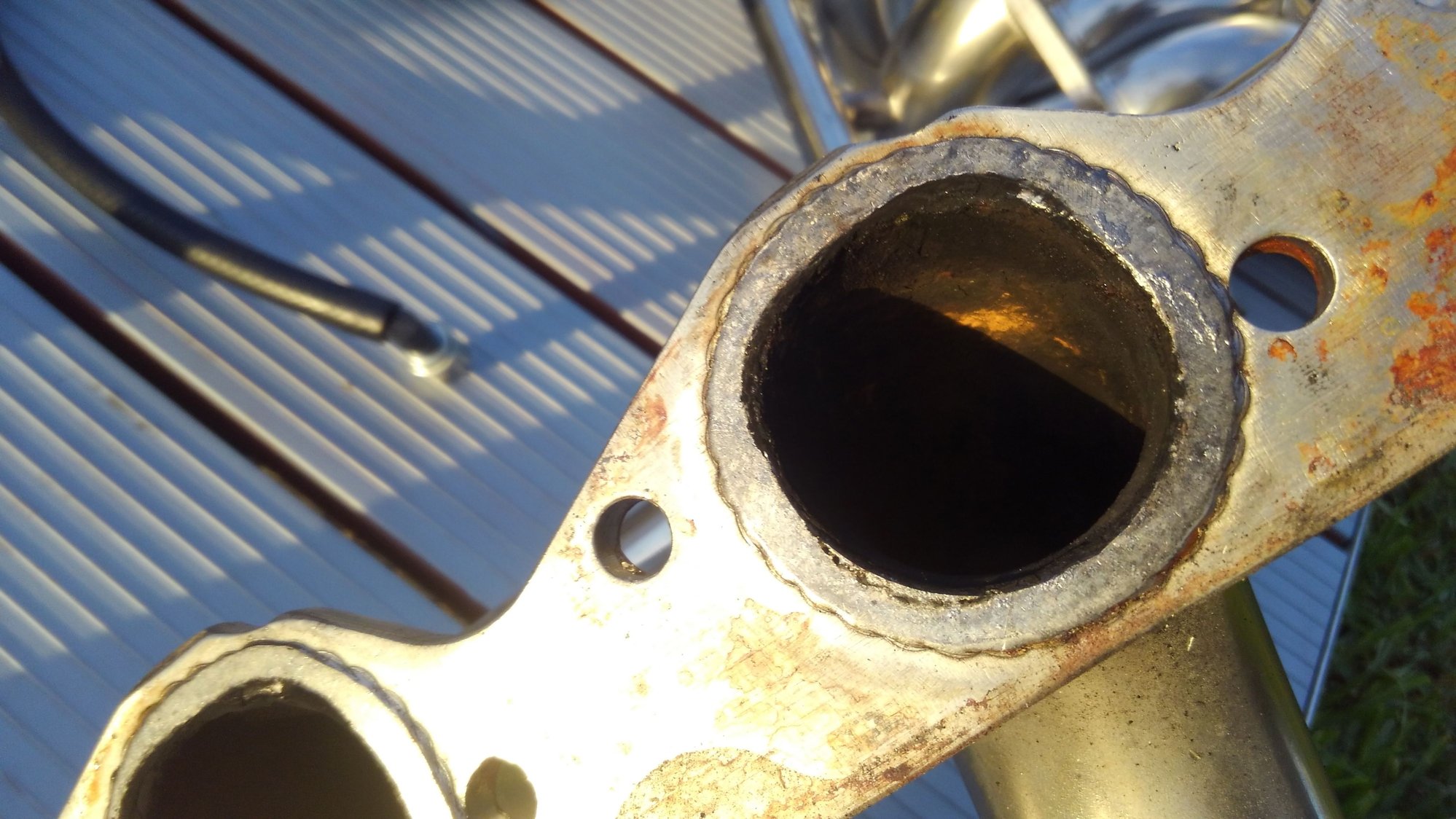

I got the intake pulled tonight. Intake manifold gaskets are quite badly deformed in multiple locations.
Also found the #5 intake pushrod bent, albeit less severely compared to #5 exhaust pushrod. No visible damage to #5 intake valve or rocker.
Exhaust ports of the headers definitely show some rusty coloration in multiple locations.

Are the #5 intvand exh lifter cups and wire retainers still there ? My phone has a .1cmx.2cm screen. I can’t see if they are their or not. Lol.
