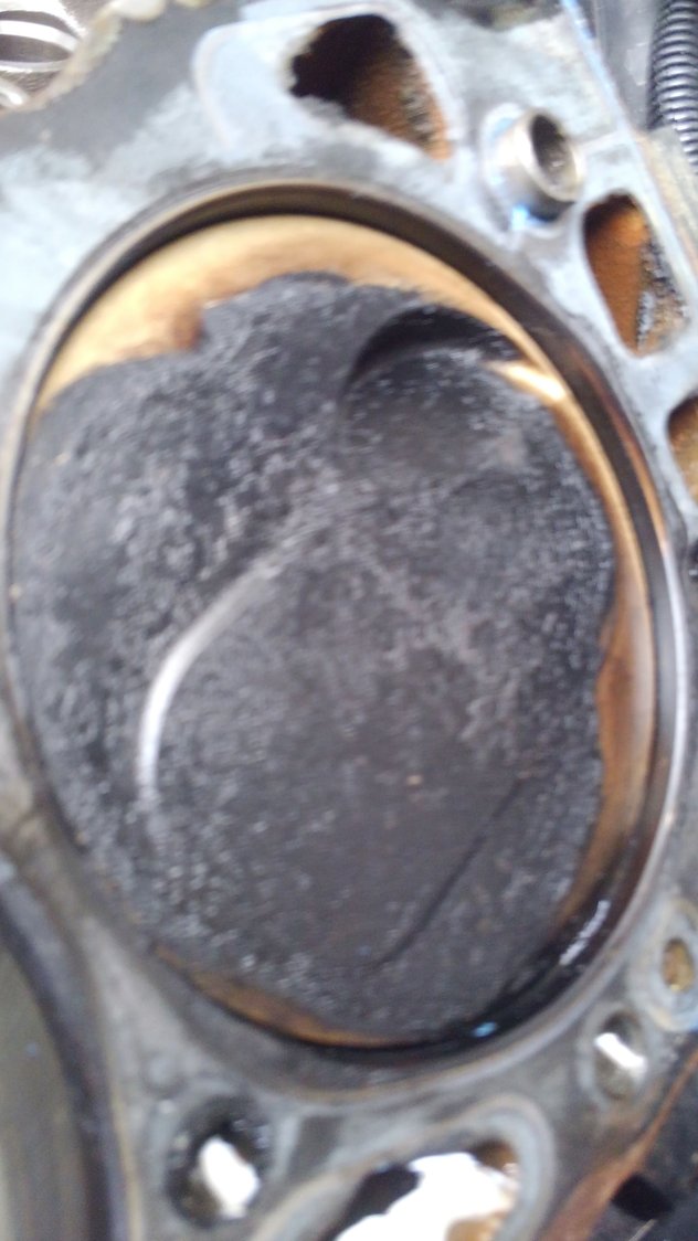

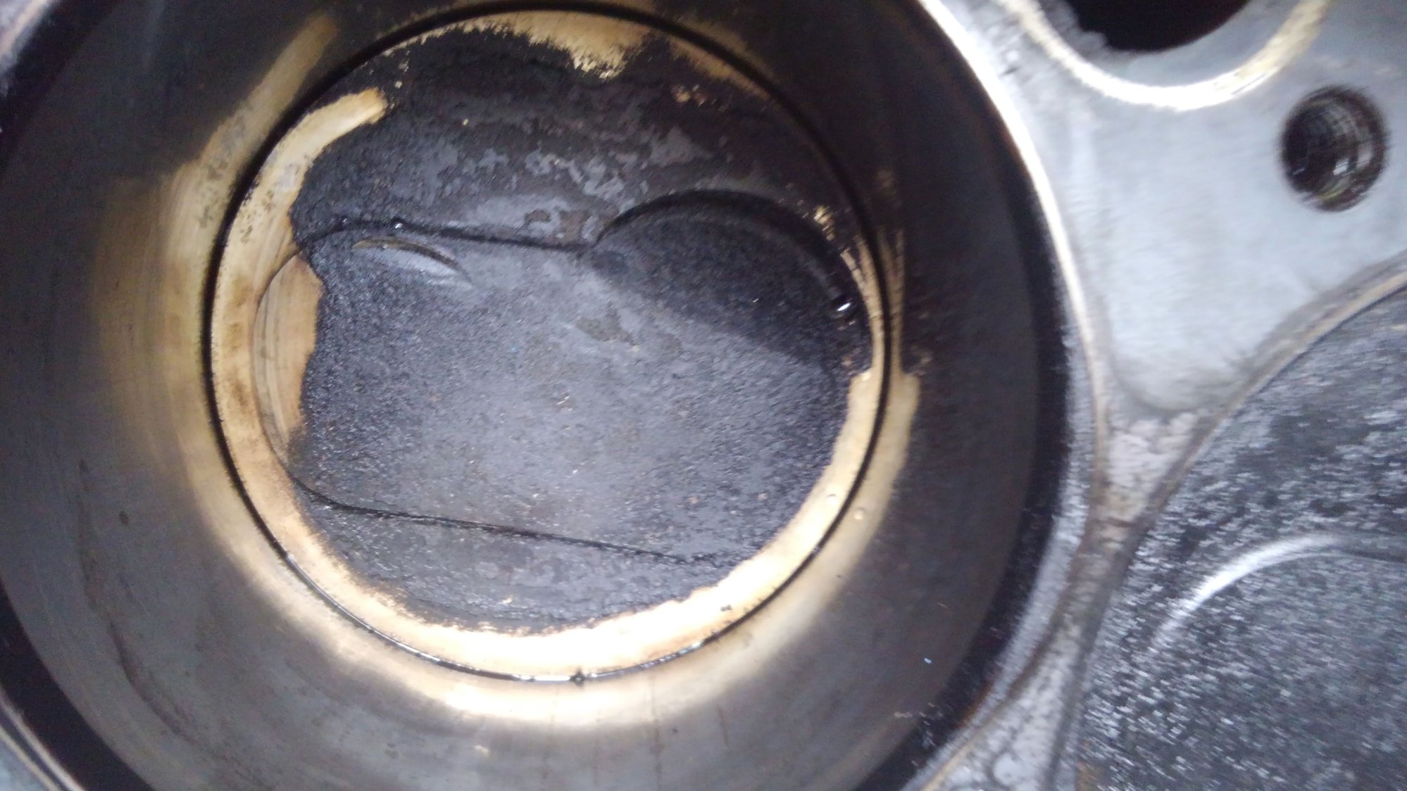

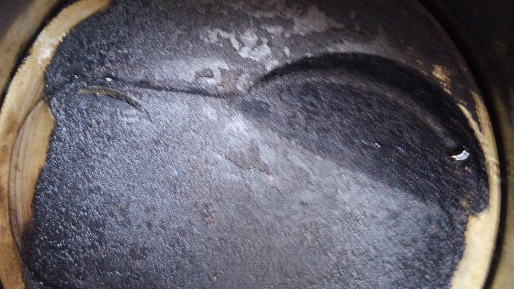

Update:
Pulled port cyl head off this morning.
There was valve to piston contact in 5 and in 7, with 5 being enough to put a ding in the top of the piston about 1mm deep. 7 just shows a "smudge".
There's clearly a lot more crusty stuff in and around the combustion chamber on 5, compared to the other cylinders. I believe I dislodged a piece of this and that's what hung the valve open, then bent the pushrod.
The exhaust ports of 5 and 7 have visible corrosion, which leads me to believe that everything started from leaky headers (a shocker, I know). I believe this was a time bomb and I cut the wrong wire trying to defuse it.
Pictures coming shortly.

Old 08-13-2022 | 08:01 AM
  #56
TomZ's Avatar
Posts: 4,303
Likes: 1,459
From: Virginia Beach
Originally Posted by DrFeelgood
Update:
Hopefully no damage to the rod.
I’m sure I have a guide plate laying around. Might be able to come up with a couple of valves too. The exhaust valves are Inconel.

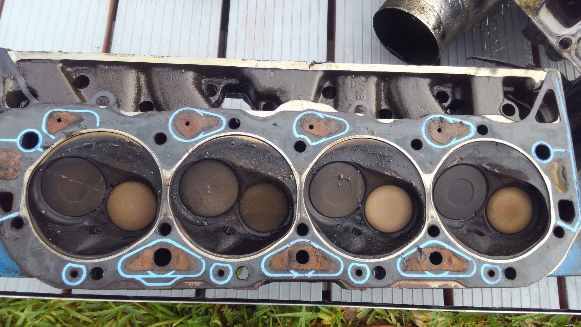

Old 08-13-2022 | 08:07 AM
  #58
TomZ's Avatar
Posts: 4,303
Likes: 1,459
What’s the head look like?

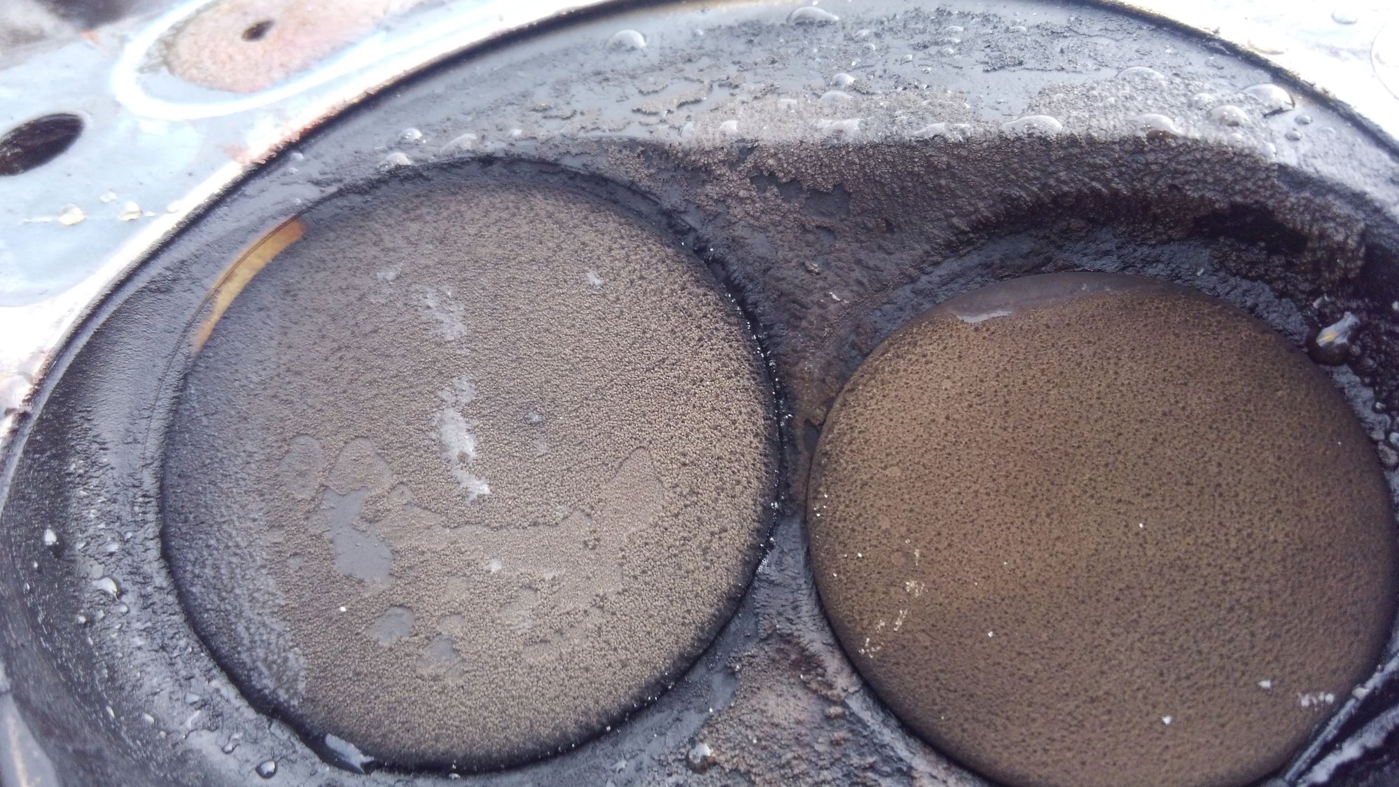

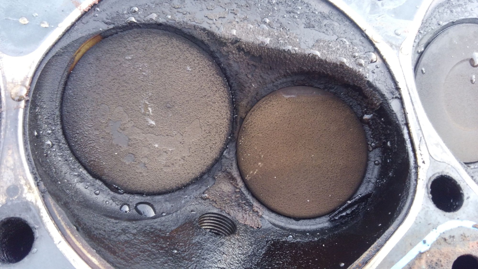

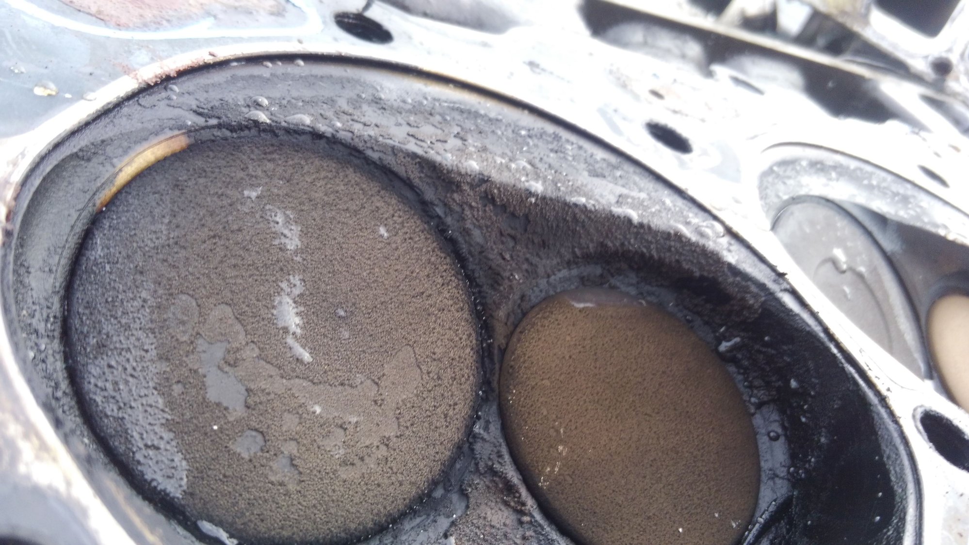

Old 08-13-2022 | 08:12 AM
  #59
Veteran: Army
Joined: Aug 2007
Posts: 1,422
Likes: 1,062
From: Orlando, FL
DrFeelgood is offline

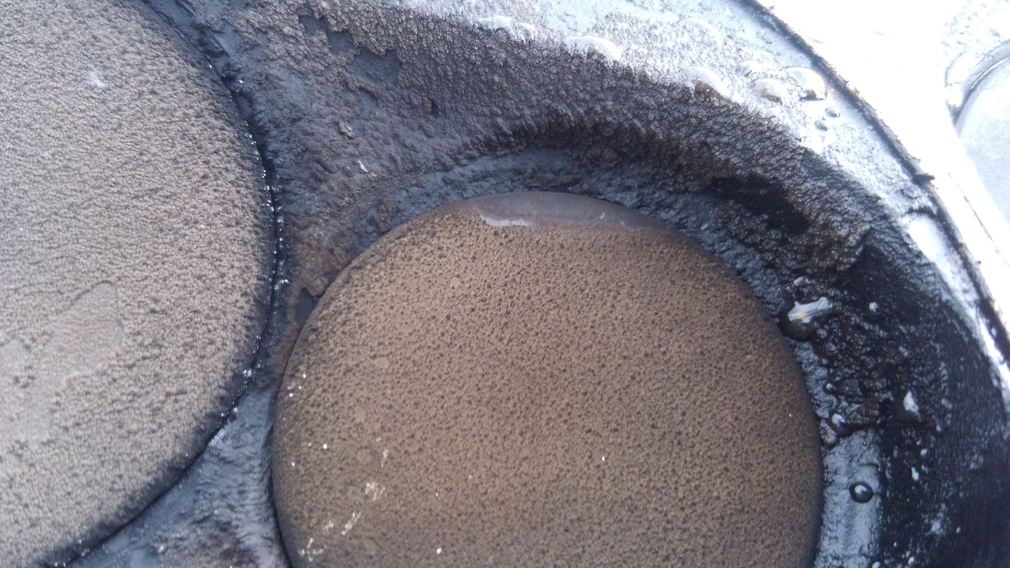

Old 08-13-2022 | 08:15 AM
  #60
TomZ's Avatar
Posts: 4,303
Likes: 1,459
Is part of the seat torn?
