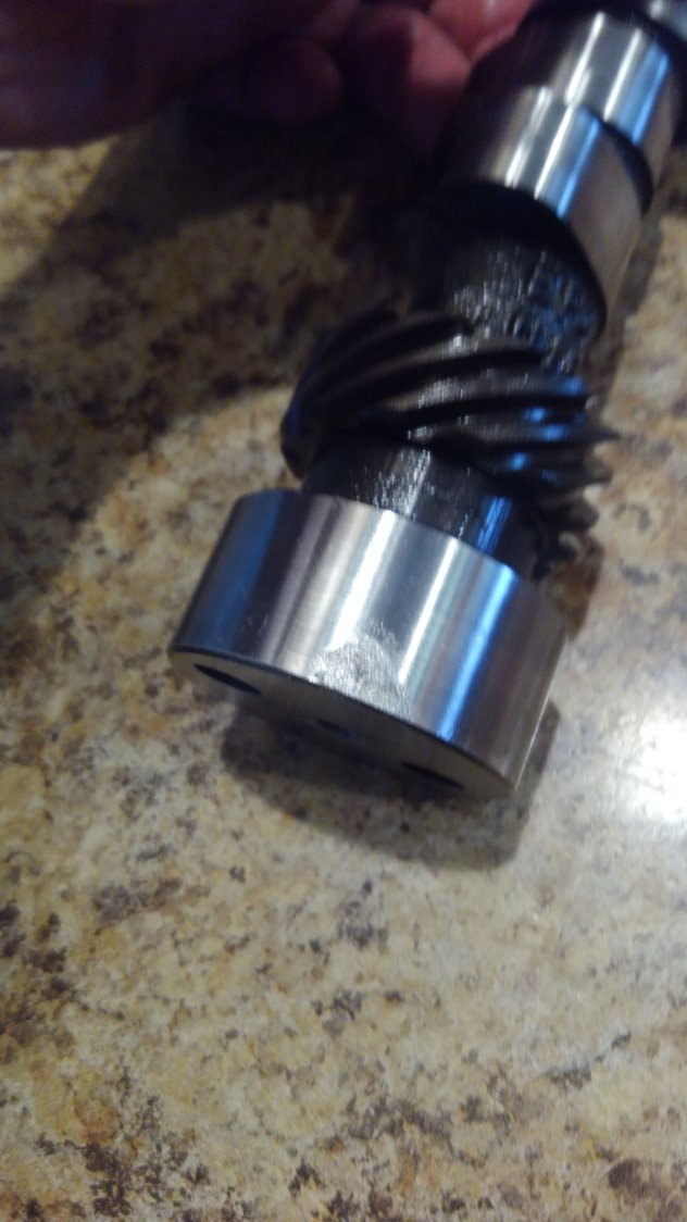

Update:
Got the balancer off, with the right tool things are just a breeze.
Cam is out. Seeing that lobe up close and personal makes me glad the cam is out.
Overall the rest of the cam looks ok, though there's a rough spot on the rear bearing journal.
Turns out this cam is NOT stock. It's a Crower 01401LM.
From Crower's site: Performance level - Beast - Superior upper bottom, mid-range and top end power.
INT/EXH - Dur @ .050” Lift: 213°/222° RR: 1.7/1.7 Gross Lift: .512”/.540” LSA: 112° RPM: 1850 to 5000 Redline: 5500
So, I guess I buy one of these same Crower cams and slide it back in, assuming that somebody at some point tuned these ECMs for the cam?
Input is welcomed.

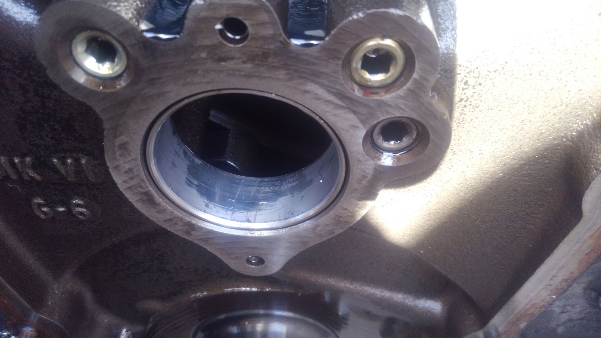

Cam bearings have some discoloration/scuffing. Looking more and more like this motor needs to come out.

Originally Posted by DrFeelgood
Update:
Input is welcomed.
Well that took a real turn! Also, that’s not a billet cam core.
Probably a good idea at this point. Do you have an oil filter you could open up to inspect?

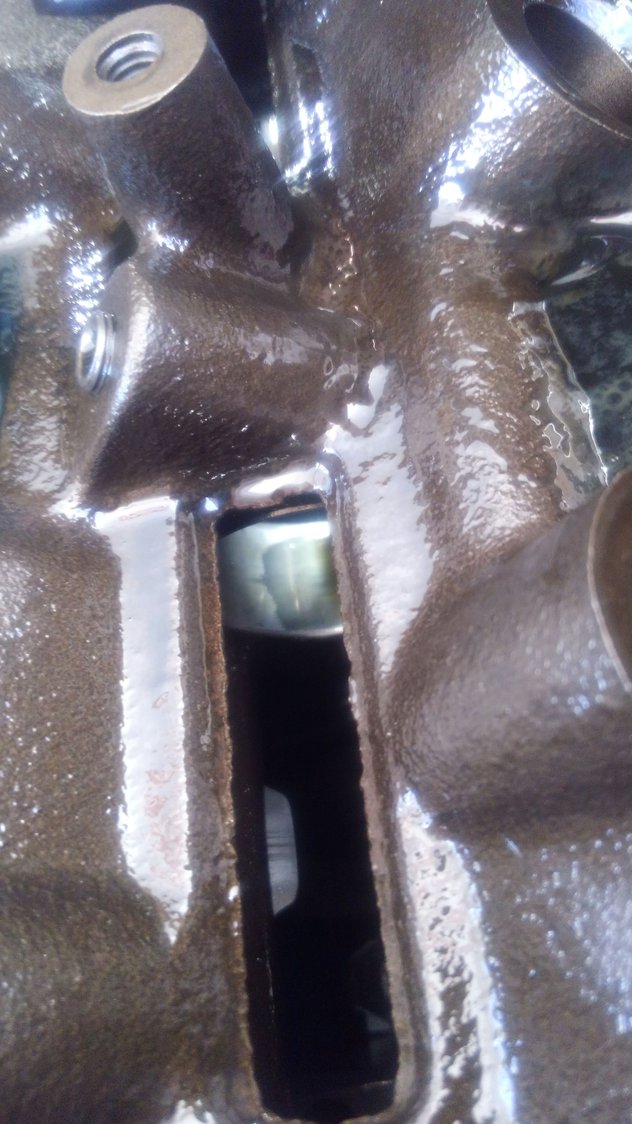

Another cam bearing pic, no bueno
