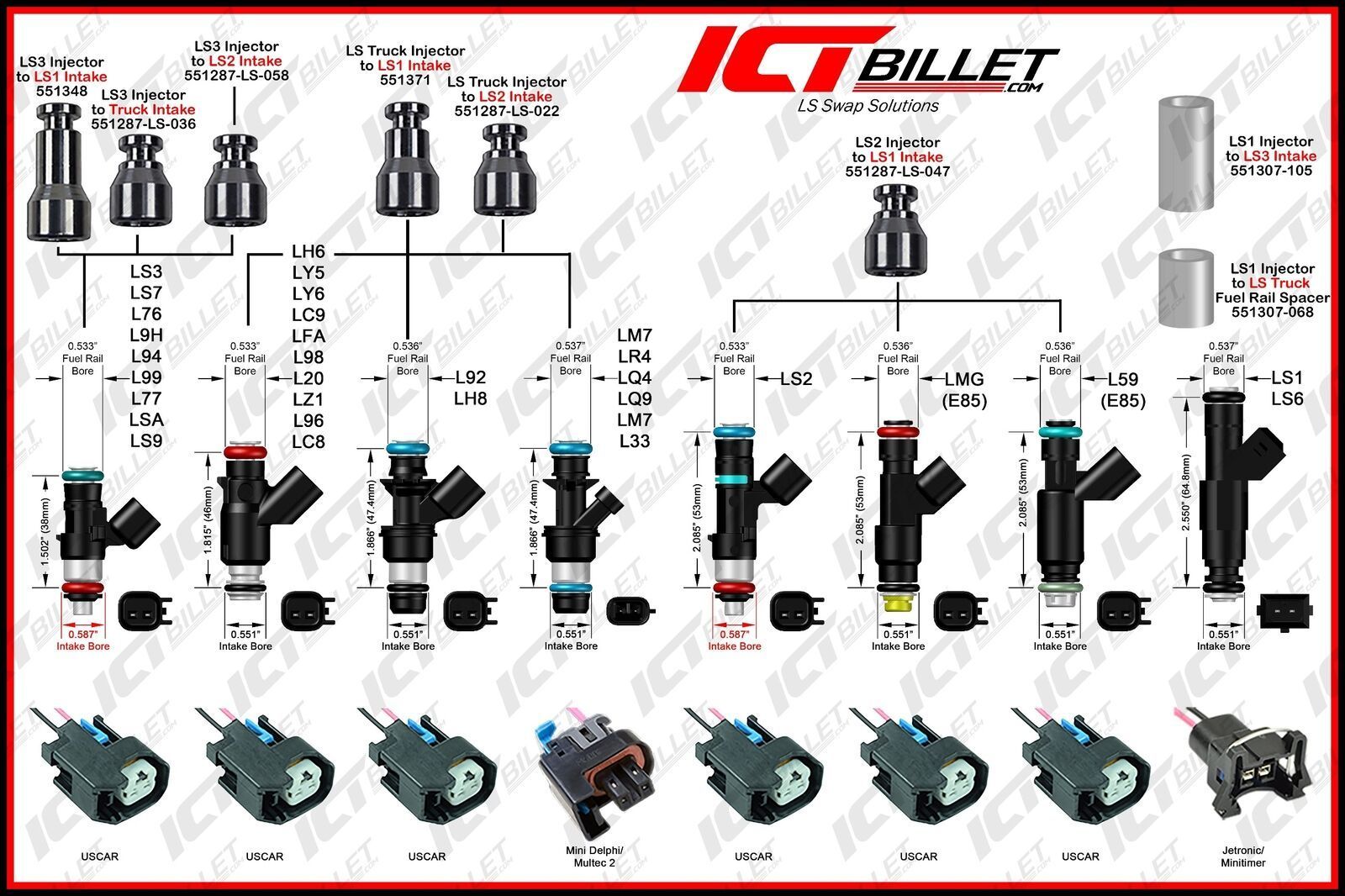

Old 09-21-2022 | 10:09 AM
F-2 Speedy's Avatar
Posts: 11,435
Likes: 3,963
From: Midwest & T-Rock
found this chart if it helps someone out
