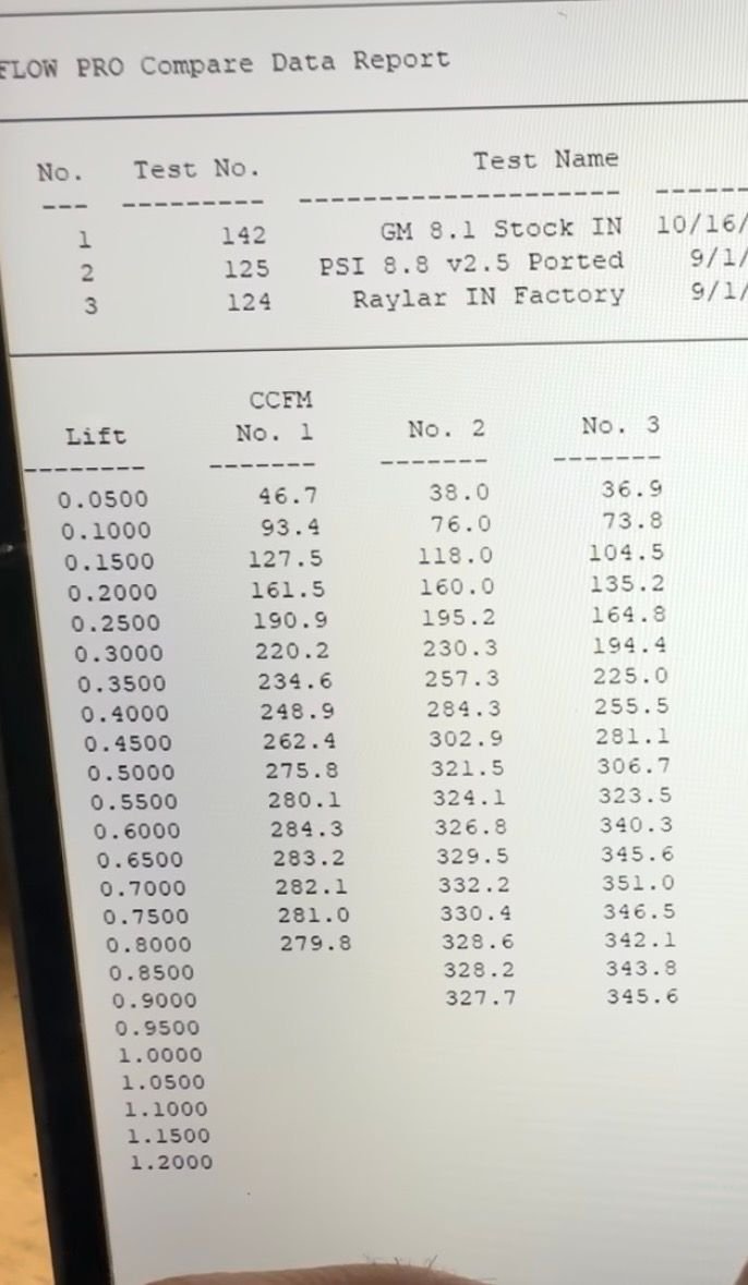

Old 04-17-2026 | 05:01 AM
  #140
Posts: 3,860
Likes: 793
From: St. Pete Beach, FL
Stock 8.1, ported 8.8 psi head, raylar head.
It’s an LS head design, but it hasn’t been enlarged enough to support high RPMs with 535 cubes. It’s only got a 2.19” valve. There may be potential there, but you’d be wasting lots of time porting cast iron.
Looks like the stock 8.1 could support 570hp, the ported 8.8 665hp, and the raylar up to 700hp.
Not a lot to love here except the price for a used one. There may be a decent cheap combo to be built with a bigger cam in a stock motor, but otherwise normal aftermarket bbc stuff is a lot better. The 8.1 is not siamesed. The 8.8 head doesn’t look like it can handle high lift or big springs with out mods, according to this guy in the video.
If this guys cnc program is reasonable, and the stock PSI pistons can clear enough cam, there’s potentially a decent cam+head stock bottom end combo possible on the 10/1 compression natural gas version. You might need intake porting to match and fuel system changes to work on gas though.
8.1s have a piston that isn’t ideal and a weak rod. Not sure how the PSI compares here.
