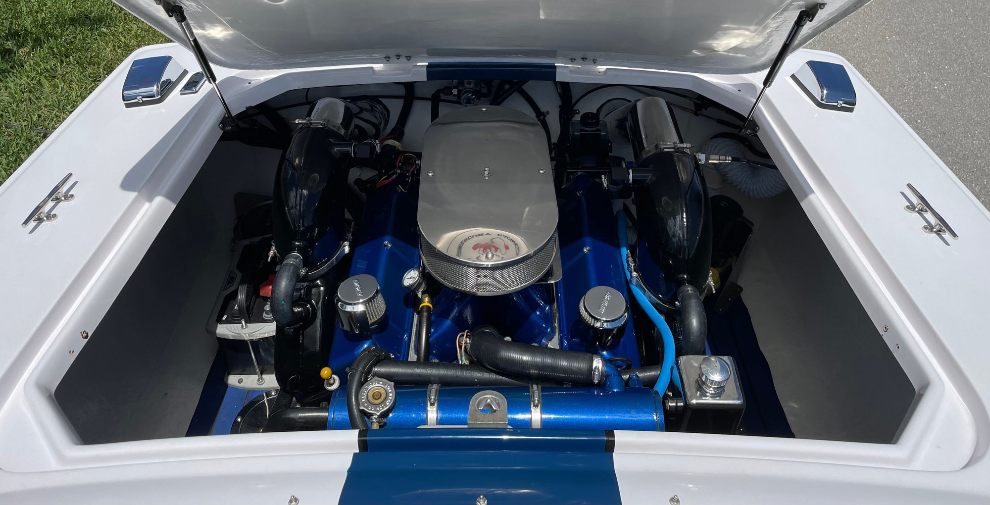

I had my gen6 502 mag mpi redone. It’s a carbed 540 now. I re used my closed cooling system and am running dart pro 1 heads. I would 100 percent do it again.
