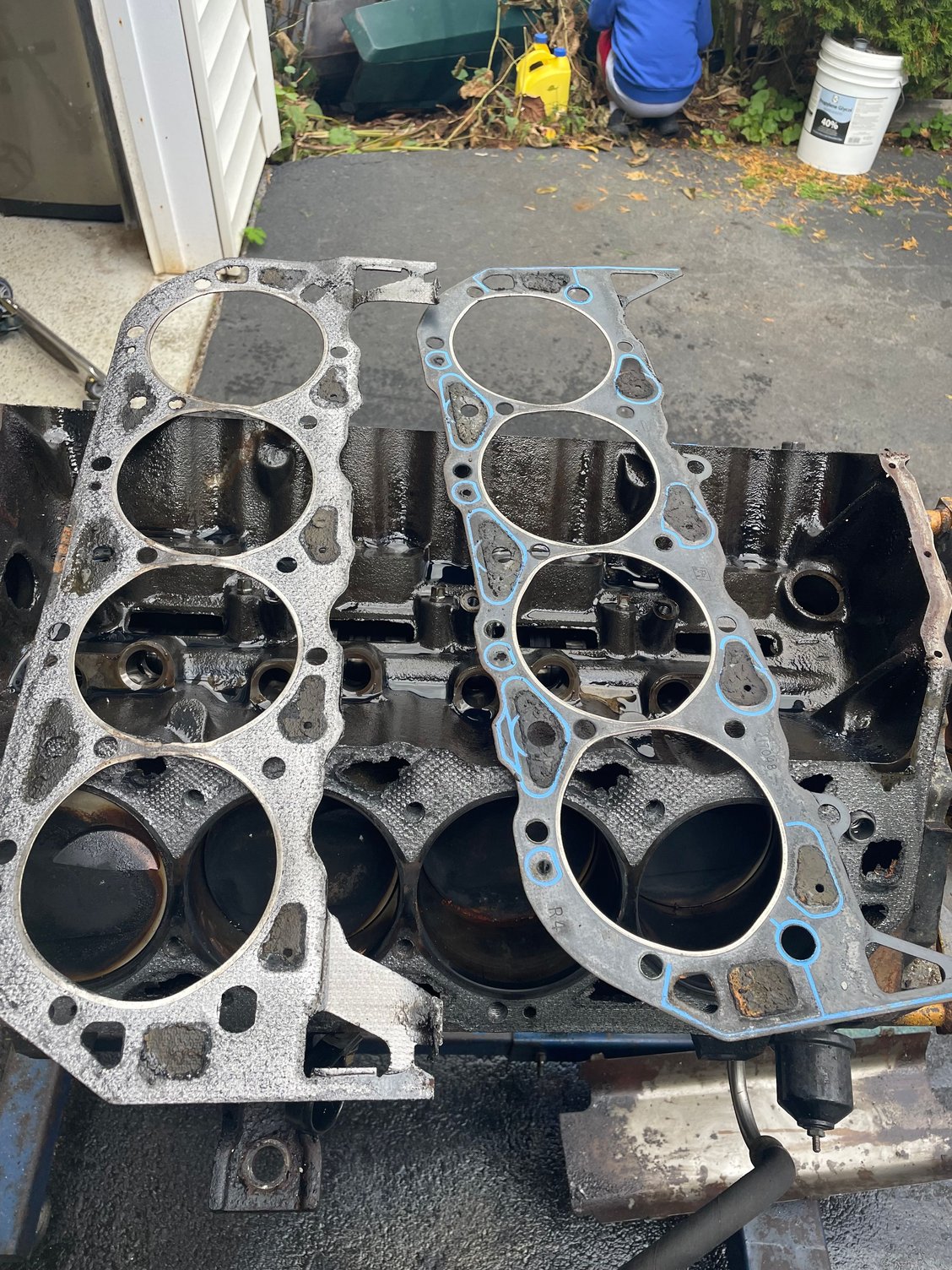

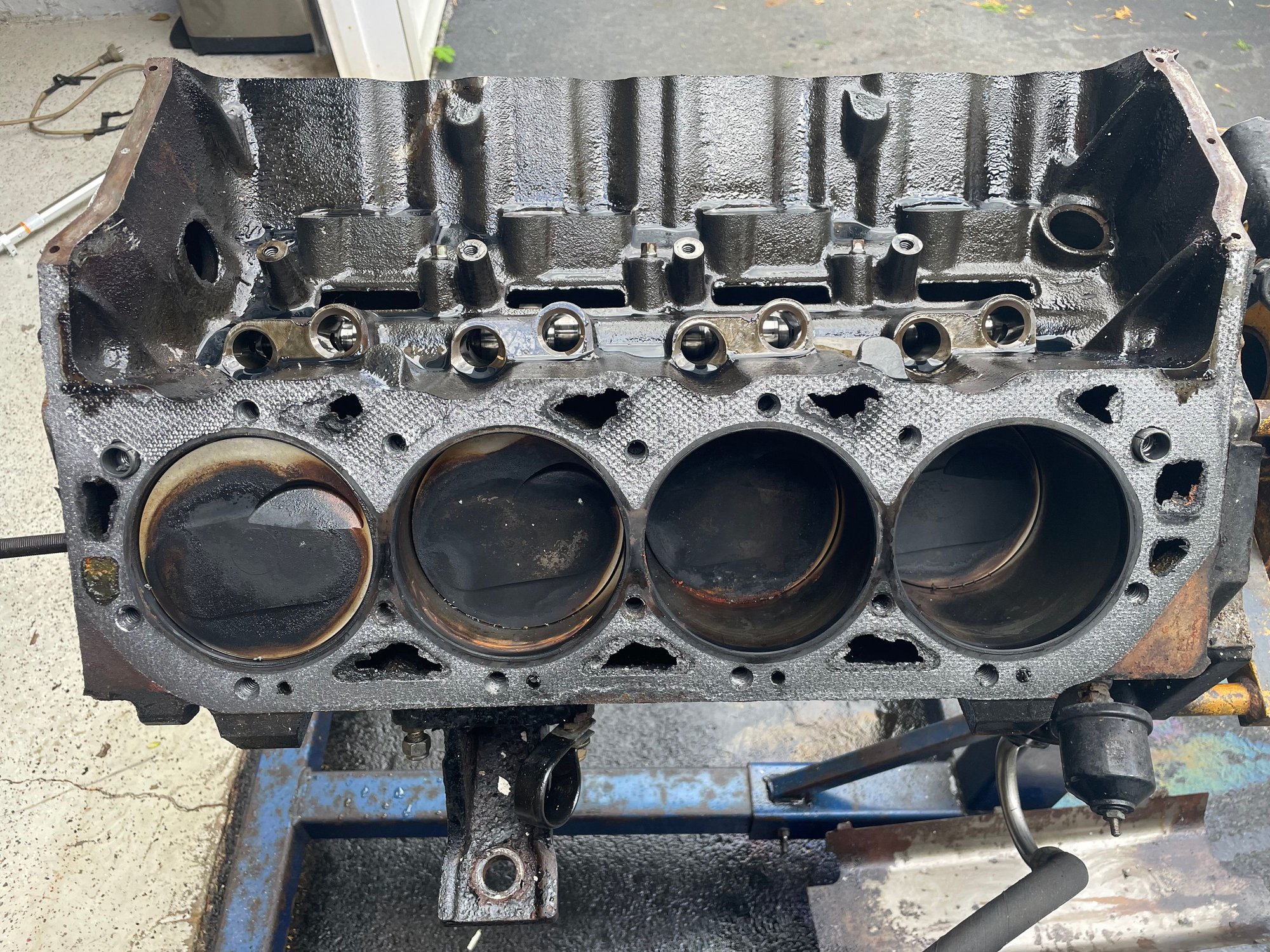

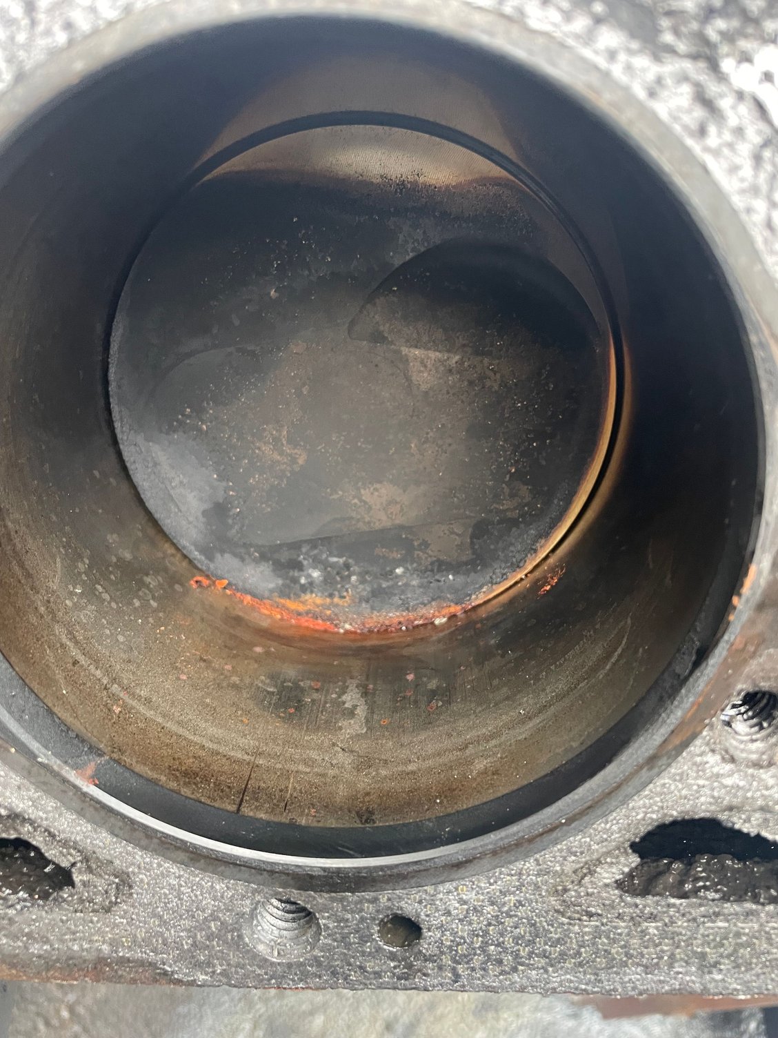

Stock Iron rectangle port heads. I was thinking heads would run me around 3k. Am i in the ballpark?
So the summer of 2021 the boat would run 59-61mph and this past 2022 season I saw it struggle to pull RPM and I couldnt get over 58mph but by the end of the season it was stumbling above 4K and could not run over 45-48 so I knew things were going south and before a total failure it was time to pull it apart and thats when I found 2 different head gaskets and the ****ter of the two ****ty gaskets scorched and water was sitting in one cylinder. The head was removed about 5 weeks after the boat was taken out of the lake for the season.
