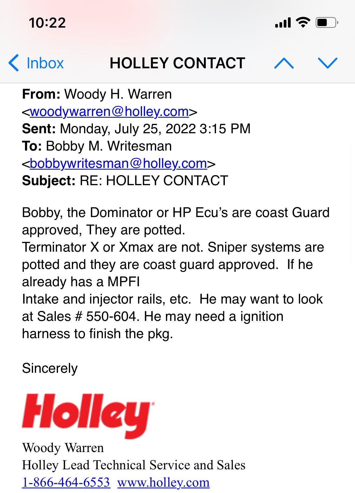

Originally Posted by TeamSaris
Sniper is not intended for marina use. I know they claim its USCG certified, but it isnt potted or water resistant. Spring for HP.
I wonder if they upgraded Sniper? I was inquiring about the multi-port and then Holley tech wrote me this back. I still plan to take your suggestion going multi-port with HP but do I use the 4150 or 4500 flange TB kit?
https://www.holley.com/search/?q=Holley%20HP
