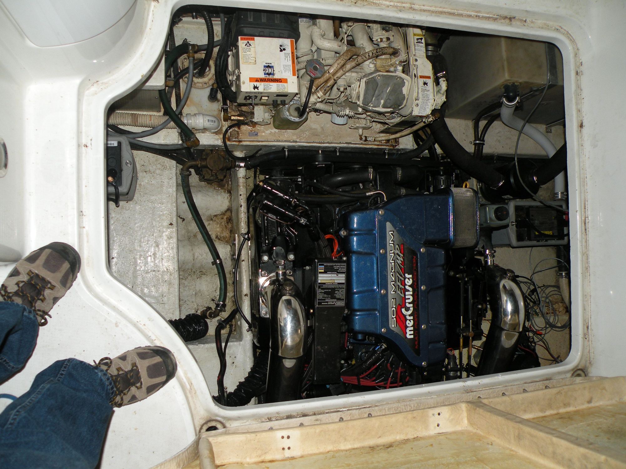

I am going to order the oil temp gages but need a little help. There's a variety of sending unit sizes so I need a little help with where it goes. I have a spot in the side of the oil pan which I think would be perfect however it's pretty high on the side. I stuck a bent piece of wire in the hole and down 2" and no oil. Oil shows full on the dipstick. I'm assuming that it would get oil splashed on it however that doesn't seem to be the best location for actual data?. Side question, why is there a plug in the side of the oil pan on a factory standard 7.4" Looks like it could be used for a turbo return line?
There's a spot on the block above the oil filter. Is that for pressure only?
I also use the stock filter relocation block still located by the exhaust riser. This would be oil that was already cooled so probably not the info the gage is looking for?
I use an onboard pump attached to the drain plug for changing the engine oil instead of sucking it out the dipstick tube so not sure I could use that location unless there is a fitting that would accommodate both the sensor and the oil change pump.
Thanks for your continued help.

Put on the filter head, easy
Its before cooler so you will see how hot the oil gets before cooling

AllDodge, I'm probably not understanding your location of the sending unit. My understanding of the install of the cooler and lines is that the oil line from the block goes directly into the cooler, out of the cooler to the filter, out of the filter to the engine block correct? Are you talking about the location on the block above the filter as shown in the pic? Thanks for your help.

im coming off my remote filter into a T with the sender data in that input hose. Put it wherever is convenient for wire routing. My thoughts mirror the others here what’s the temp before the cooler.

Install a remote filter and install in the filter head
In pic see the brass fitting on the filter head, that is the sensor which goes to the gauge
