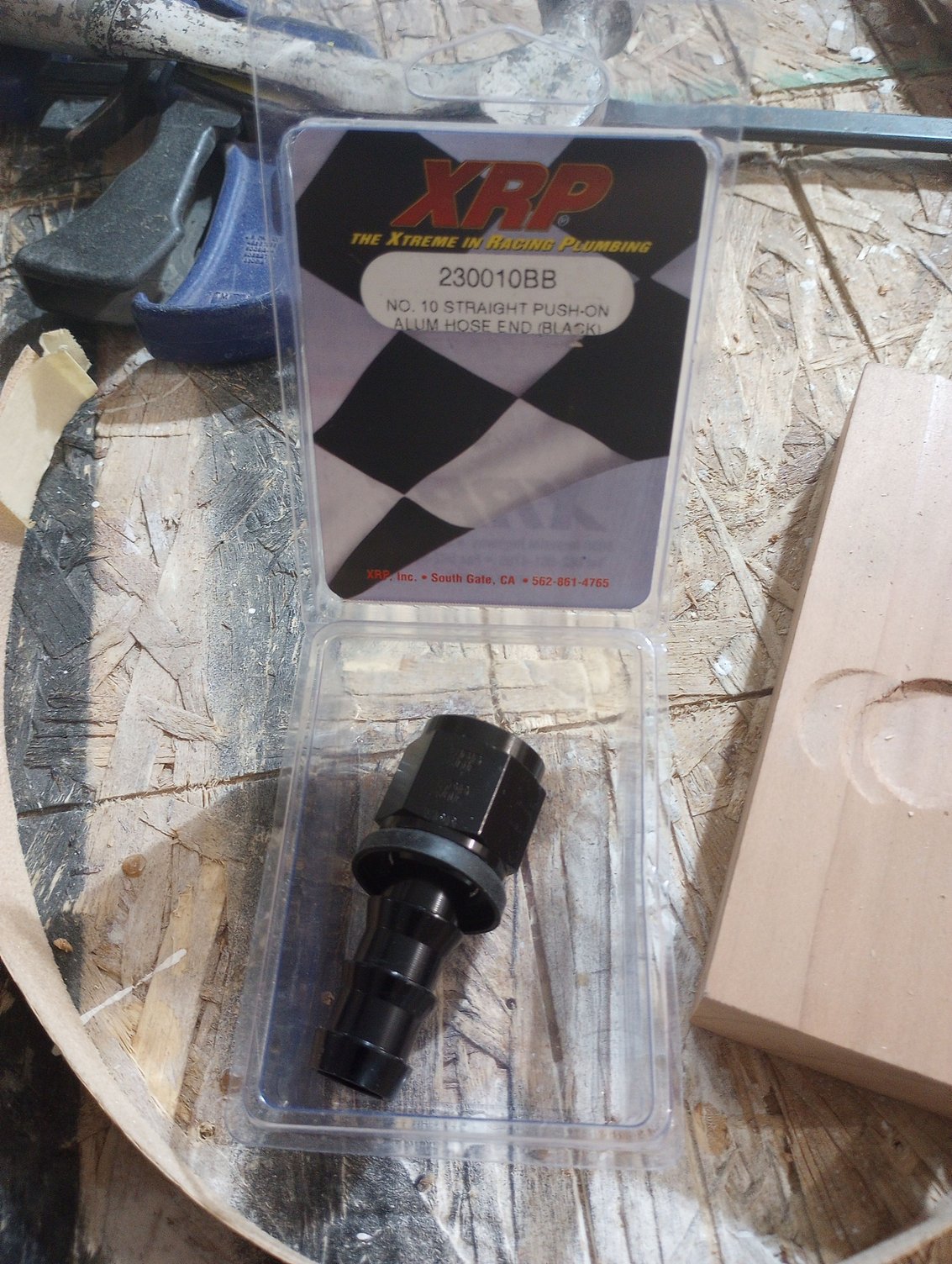

I bought the misc. AN fittings through Hardin and CP. XRP line. These are the only AN fittings that I have so no mix and match other than the way some of them connect. Some are push on, some not.
Thanks for the heads up Tom about over tightening. I've been known to do that. For the oil lines they are the push on style and I did buy the special tool and the clamps for this type of hose.
At the time, I didn't know -10 would be overkill. I think I selected -10 because the Hardin remote oil filter block at the engine was sized for -10. I'm assuming it's not a "bad thing" just overkill and overkill is fine with me.
These coolers are pretty big (overkill) and supposed to work up to 700hp. They are the 3"x23" and they have the power steering loop in them too. I suppose I will find out this spring if they are too big. What is a "desired oil temp" while underway?

I thought you were using compression not push lock, carry on
