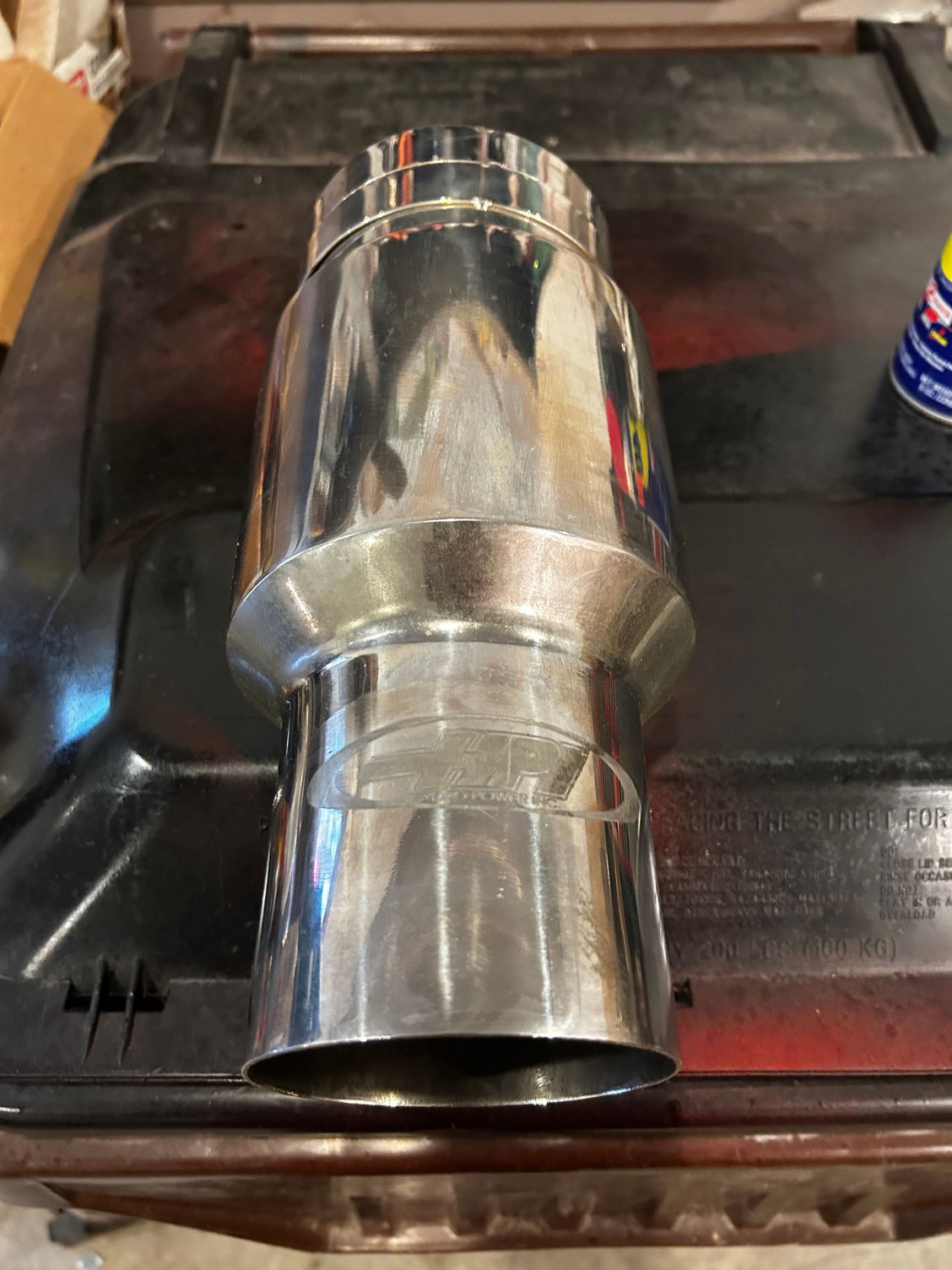

HPI is currently into Harley performance parts if it's the same guys. https://www.horsepowerinc.net/
Been around for 20 or so years.
Guess maybe they ventured into marine at one time. I was unaware if so.
Pair listed on Ebay.
