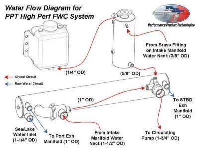

Just to be clear, we're talking closed thermostat operation, where the engine water pump is flowing water through itself, until the thermostat opens progressively, and flow is directed to cool through the heat exchanger.
#48
Posts: 224
Likes: 23
Agreed. I think we're talking at odds. My closed cooling setup is full flow, so even when that stat is completely closed, the block gets a full flow of coolant circulating, it's just not going through the heat exchanger.
Nice even block & head temps. It was the small bleed off the top of the circ pump I had closed off - which means a bit of coolant bypasses the engine entirely. Since my block is full flow, I tried plugging that bleed and it blew the core plugs.
A more classic open cooling setup still has some water (re) circulating through the block when the engine is cold as a function of the stat housing design. Plus some people drill a small hole in the stat as well (me included on my motor that had this setup)
And then of course you have the pure seawater pump & bypass setup. Stone cold water hitting the front pair of cylinders - sub-optimal design unless you really need that much cooling capacity to have full flow from the seawater at all times.
So in the pic below (my setup), the thermostat is in the heat exchanger. It works great, although I don't like my setup from the heads to the exchanger, I'll make a nice compact water manifold that mounts on the engine at some point.
