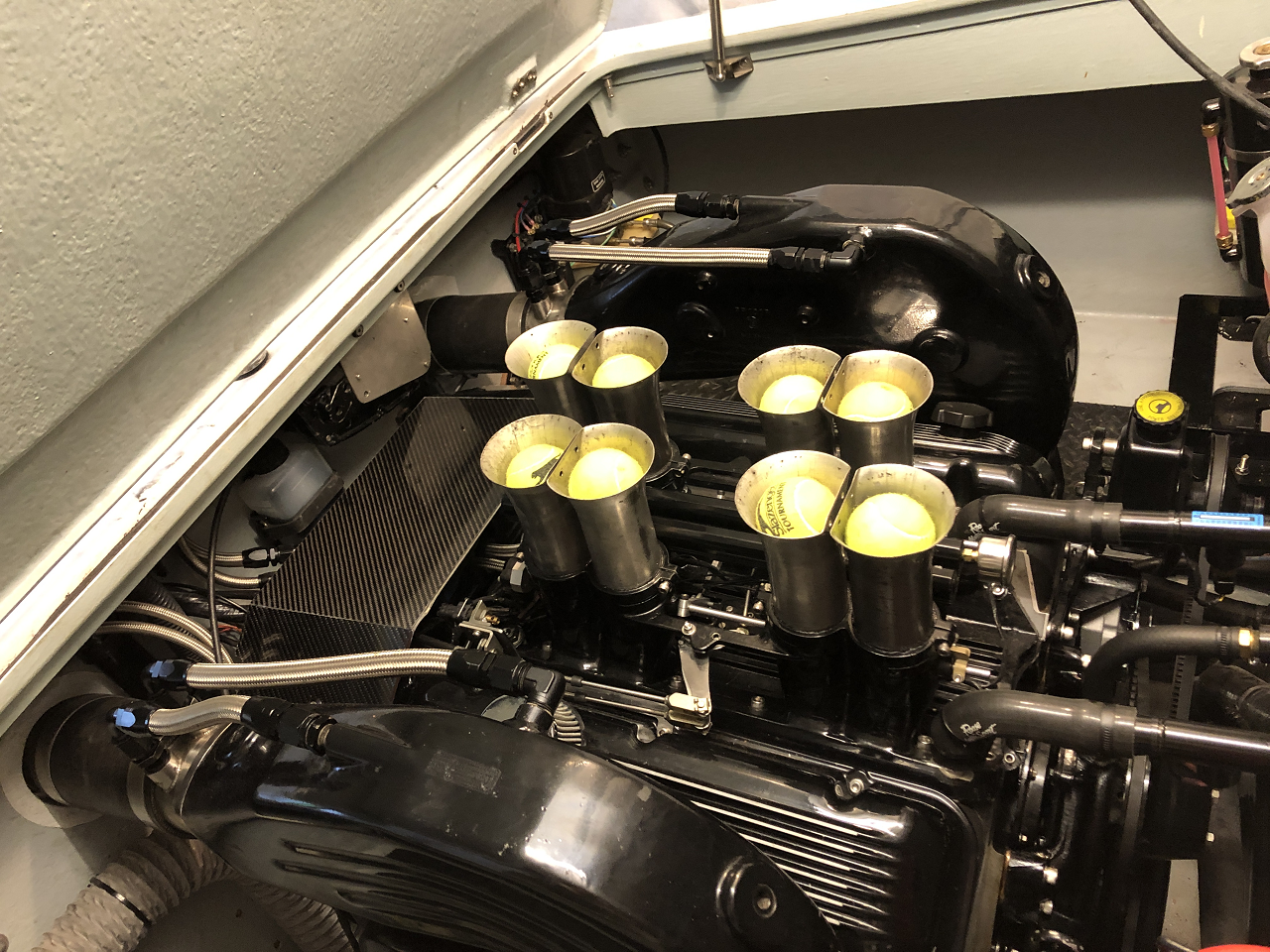

Hi All, Is anyone able to advise the best muffler than can run dry.
My motor is currently running dry to the tips exhaust with eickert headers.
However, too much cam overlap means I cannot run wet exhausts, but also need to quieten it down for marinas.
Any advice on the best muffler that would help me keep quiet in the marinas. please?
I was looking at GIL Select Sound and CMI After Firing Sound Choice as a couple of options. Are there other options, and what's "best" in terms of combining noise reduction while also not hurting performance.
Thanks

Damn that is a sweet looking motor
