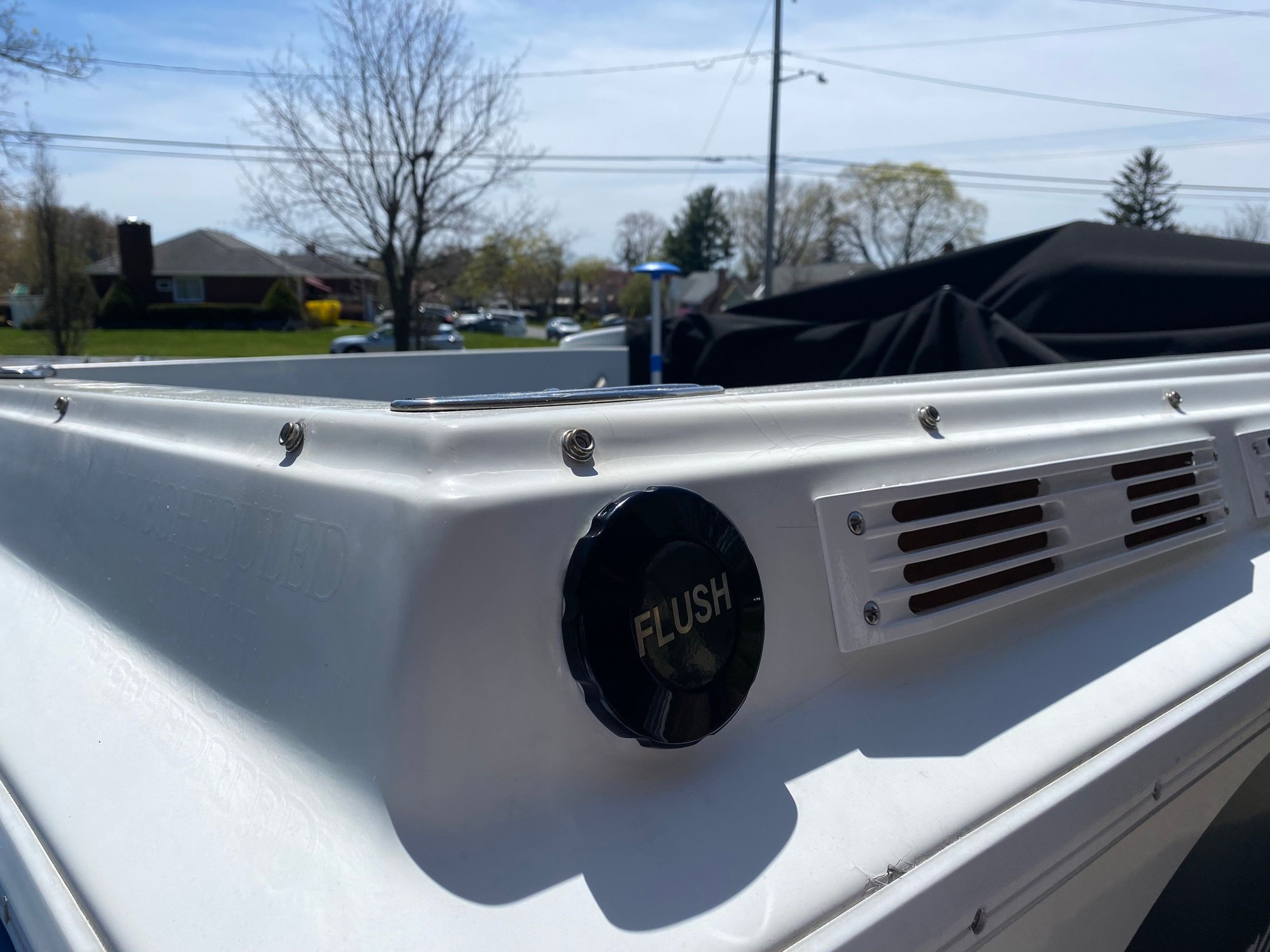

I liked the idea of adding the strainer I also added a flush port to make it easier, still.
