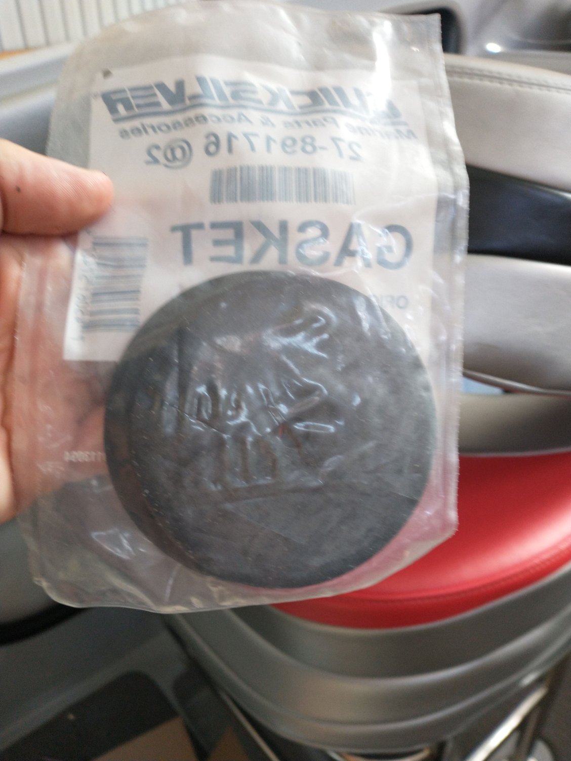

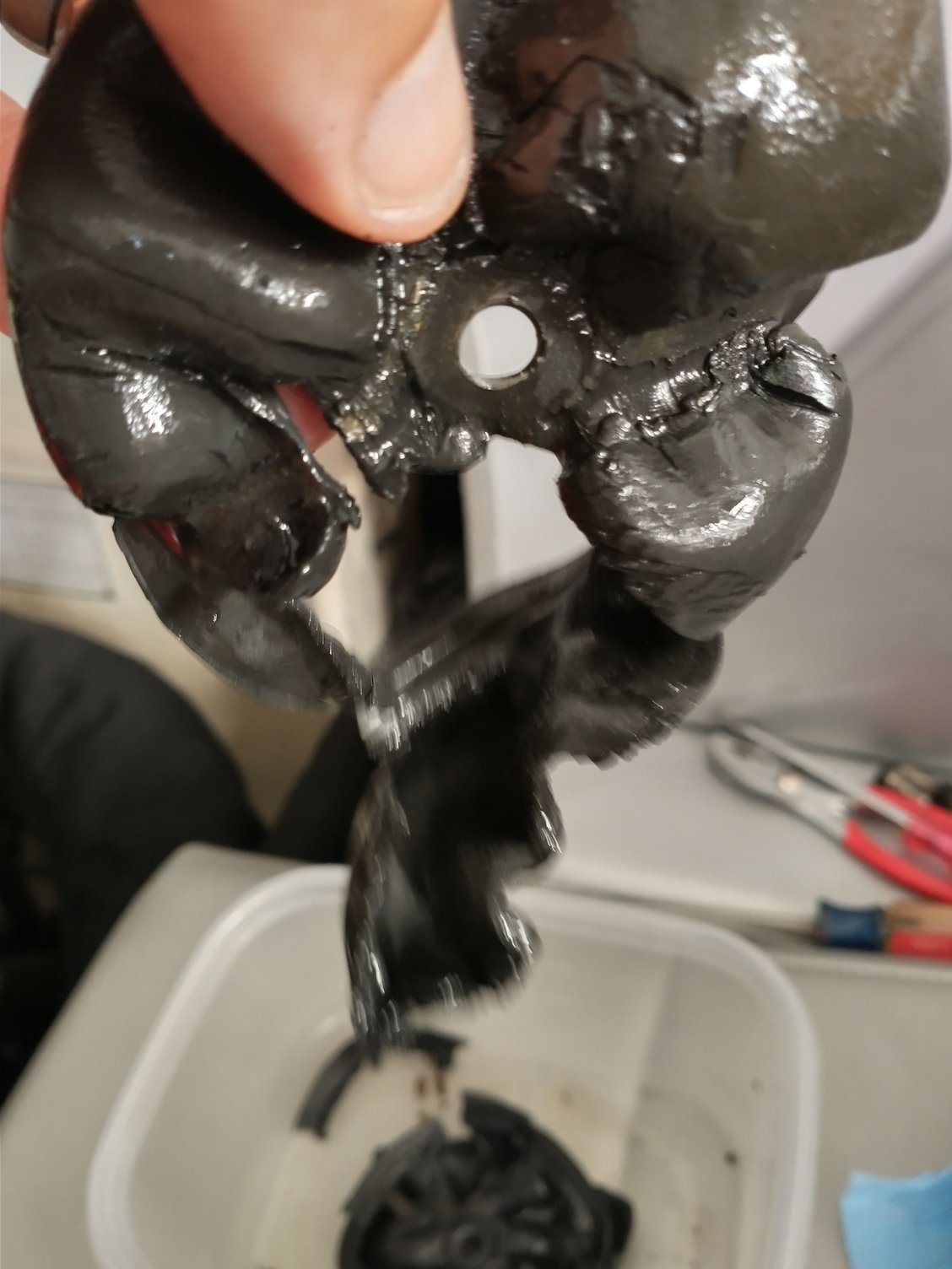

Id guess water pressure alarm......sea pump might need a overhaul.
When you scan it, check the sea pump pressure, I had a similar issue cause my sea pump pressure was too high, which is usually a blockage. I also have the Hardin pumps and change impellers every other year. Ended up being the end cap gaskets in the heat exchanger

Ok so your talking a posssible clogged up water system … what was it with the end caps ? And i read that these cannot be taken off if boat in water ?

I did it on the trailer, it's amazing what happens to them overtime, almost gummy

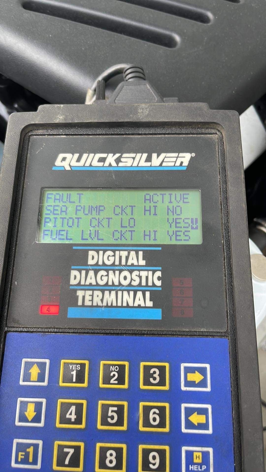

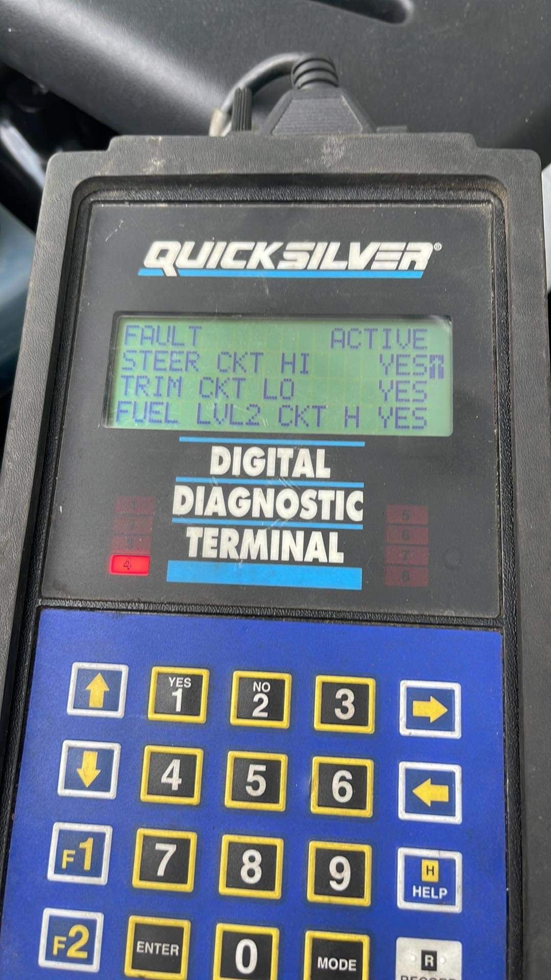

Ok guy here is the update … finally plugged the scan on that 496 HO … see the picture for codes that came out … and i could also soo that o have 100% power availability … in conclusion my prop will be replaced with a mirage plus 3 blade 23 pitch…

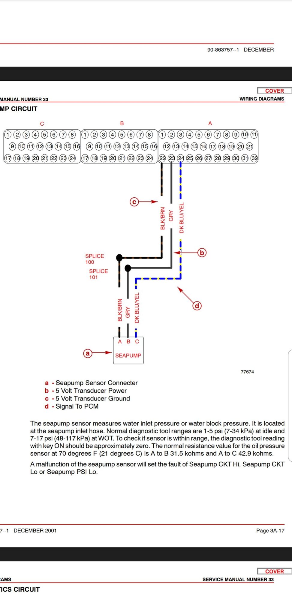

Seapump Ckt Hi is the only fault on your screen that will throw a 2 beep alarm. The other faults are sensors not used on your application.
