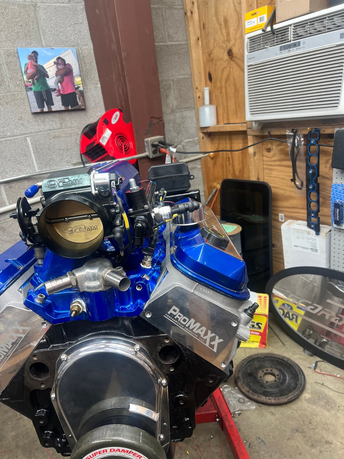

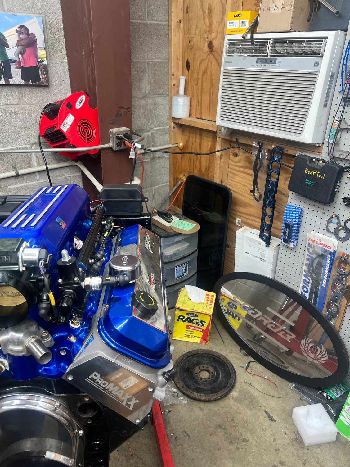

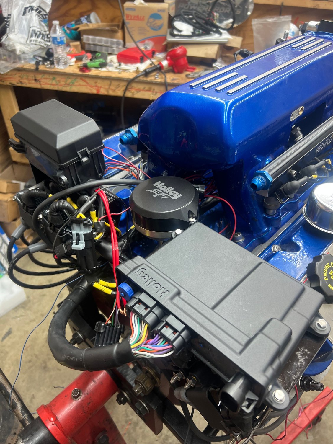

Originally Posted by articfriends
yes, it will take work to get the volute to fit over it, I cut one down w die grinder to get it to fit, the most recent one rookie posted pics of we used mill and rotary table to cut lip down and bored the volute
This is the setup that I am running with Holley hp efi and dual sync distributor and smart coils like the 700sci use.

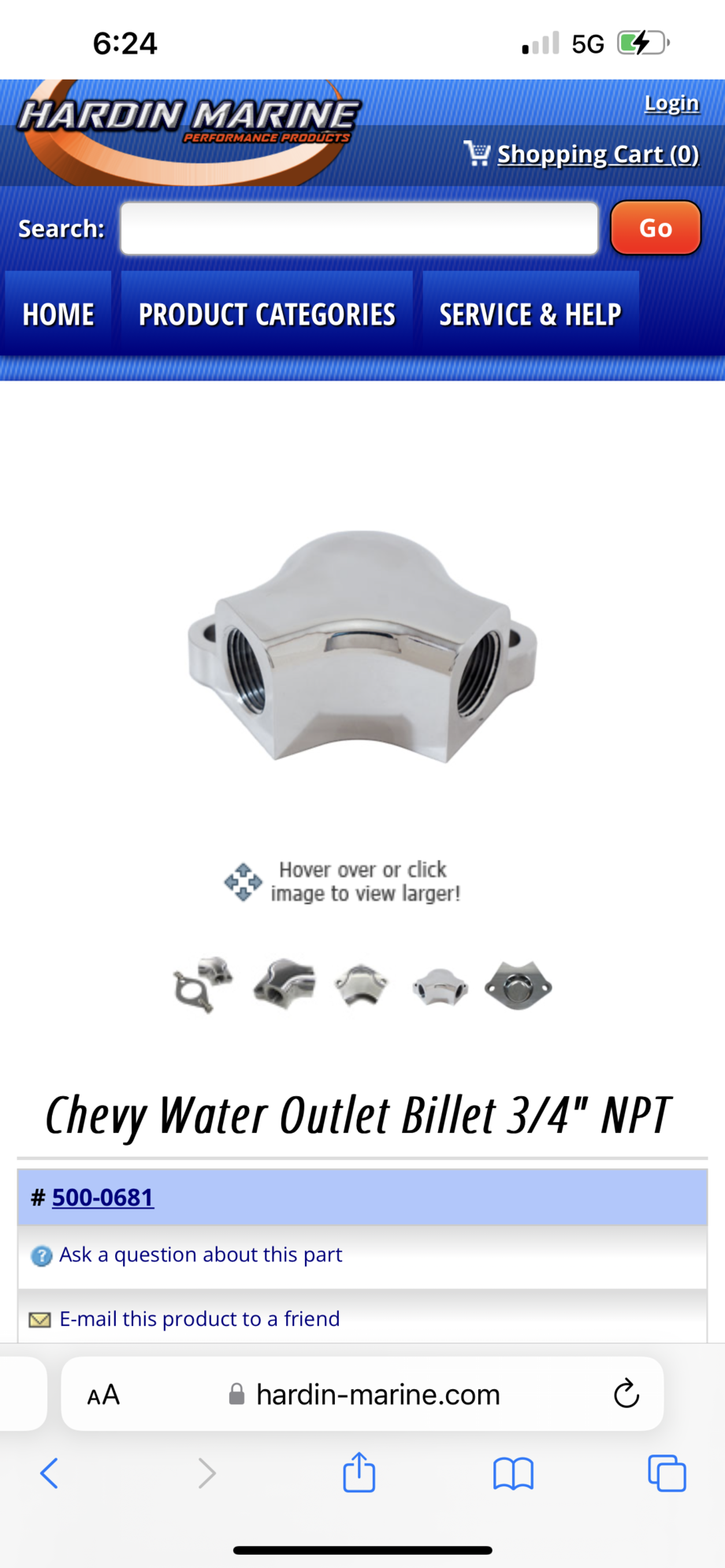

What thermostat housing are you using?
I was wondering that myself, looks like one for a jet boat
Just divided water outlet from Hardin
I have the customers 548 on the dyno, ordered this to try to gain tstat hsg clearance , the air horns already hitting the only dyno tstat housing I could get to fit at all. Gonna run it with it and without it of course and see what it does to the hp. Carb to EFI-hly-717-15_xl.jpg

That may be the ticket there to get the clearance for the volute
