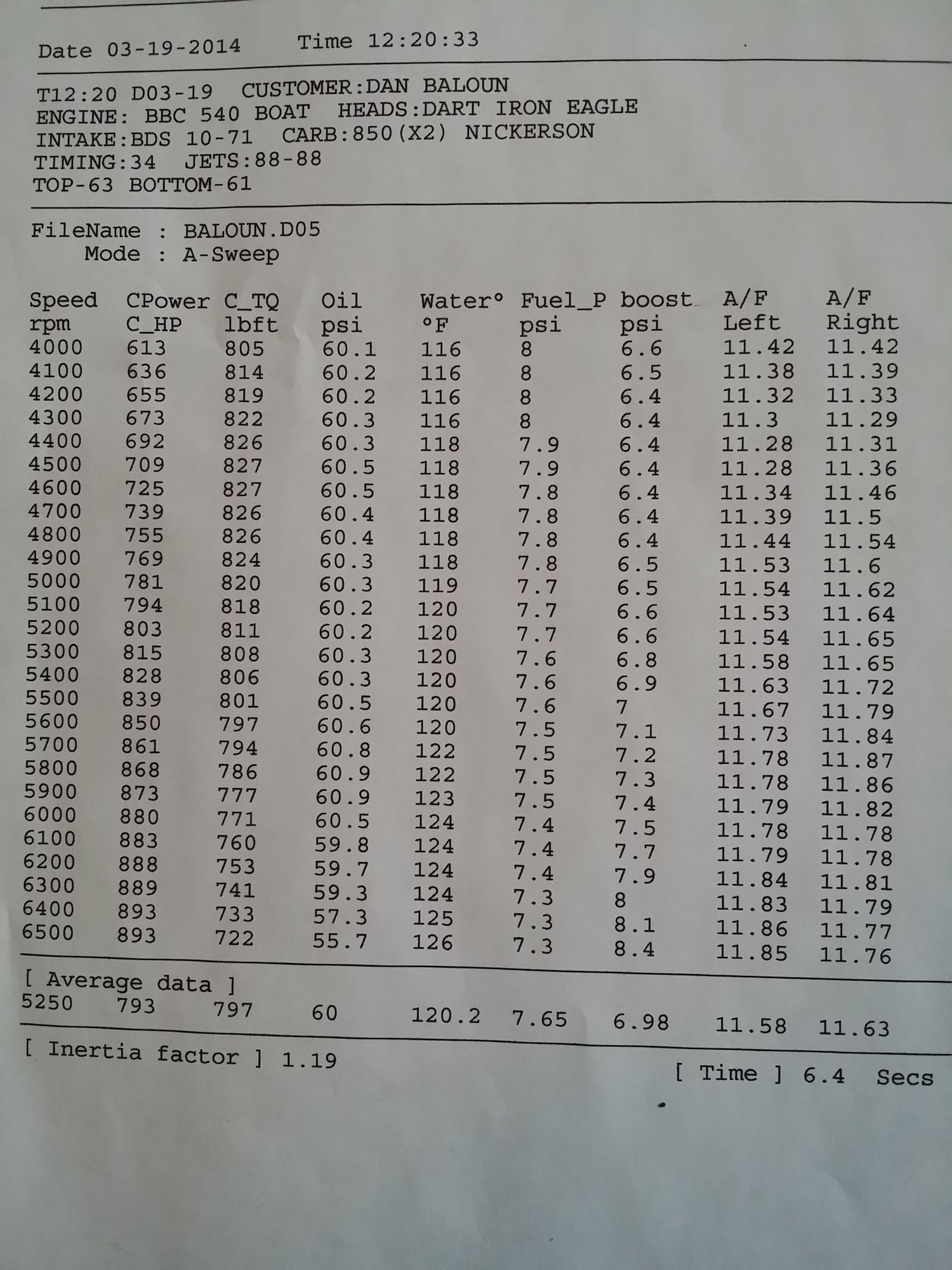

Originally Posted by articfriends
For TORQUE and LOTS of it!
Apparently not .
This was a long time ago combo but still a 540ci with 8#s of boost.
at 6100rpm I`m making the same TQ as an N/A engine on a "soft" dyno so he`s probably making more TQ than a 540 with a 10-71.
