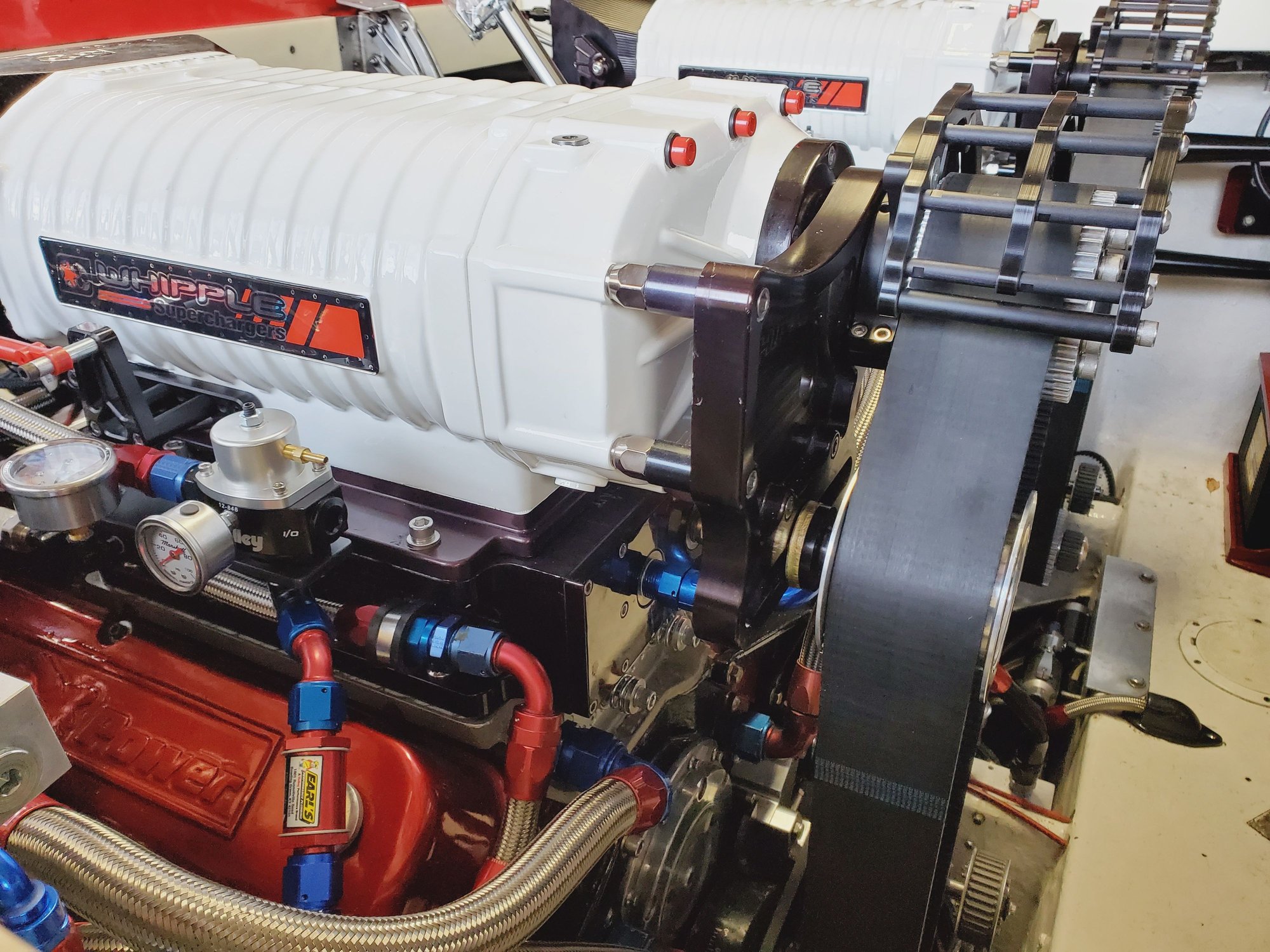

I`ve never heard that ... how many Whipples aren`t painted? I can`t think of a one.
My blowers are cold and sweating after a run, not seeing any "insulation" Latent heat of evaporation is a powerful thing.
IMOP this is a non issue.
I like white
Before and after .. my only complaint is it`s hard to keep clean.

Thanks for the great photos Dan, I was hoping you would chime in. Your engines are a thing of beauty, and I remembered your Whipples were painted.
I saw some data that suggested painted Blowers were being insulated. That flies in the face of the thermal dispersing coatings for brake rotors etc. So I was a bit skeptical.
Running your E85 must help a lot as well.
