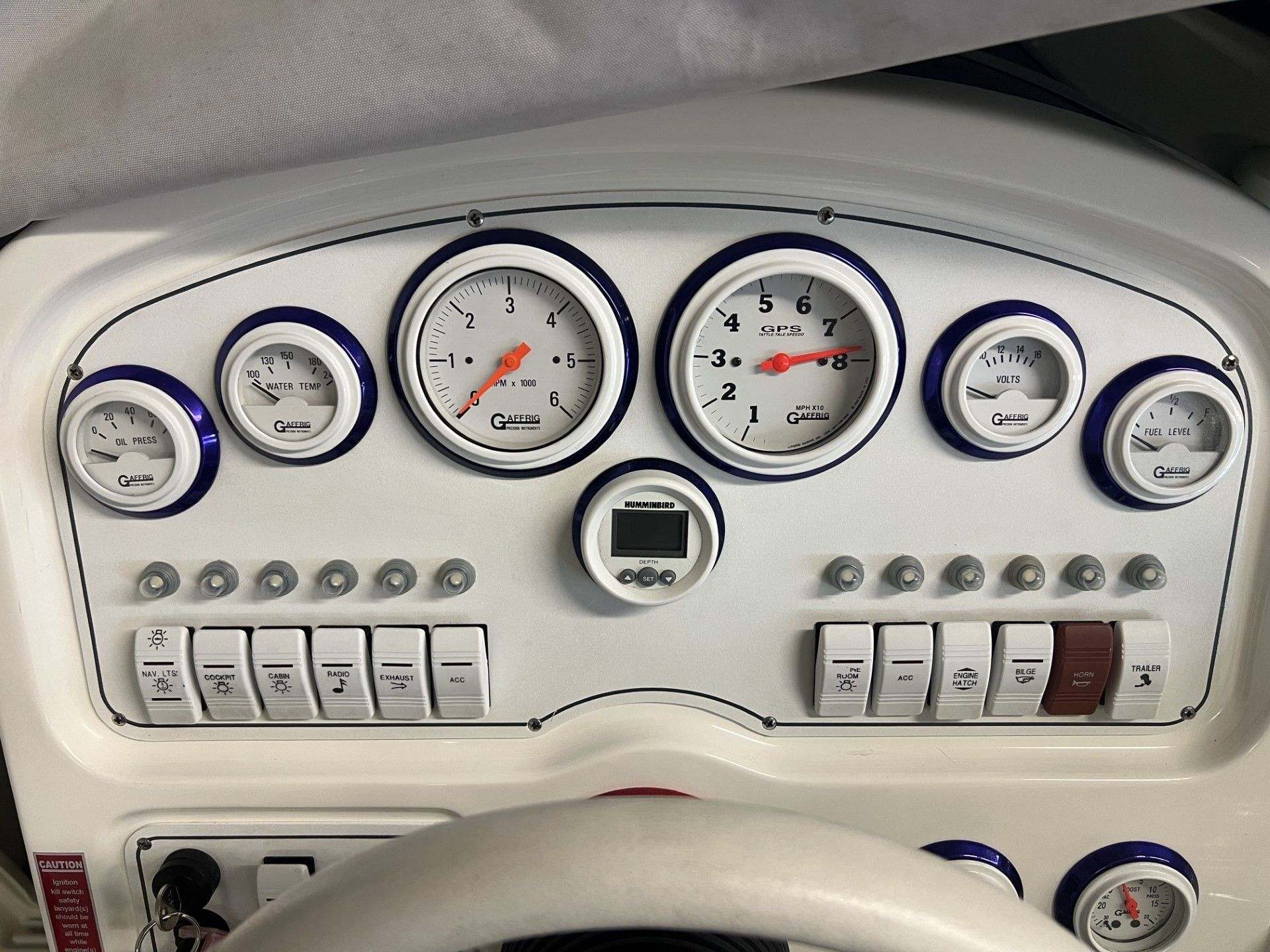

Before
After
I’m a little disappointed as the vinyl shop forgot to include the carbon fiber shadow across the whole panel, but I’m too impatient. I wanted to get it back together.
Everything is back in and working, short of firing it up and checking actual function of gauges. They all react to the key and the backlights light up.
The wire for oil temp signal is connected and strung, but not hooked up to a sender yet, as I haven’t done the modifications to the oil filter mount yet. I will take care of that when my powered trailer dolly arrives, we get some decent weather to pull it out of the shop, fire it up and do an oil change.
Thanks. Brad.
