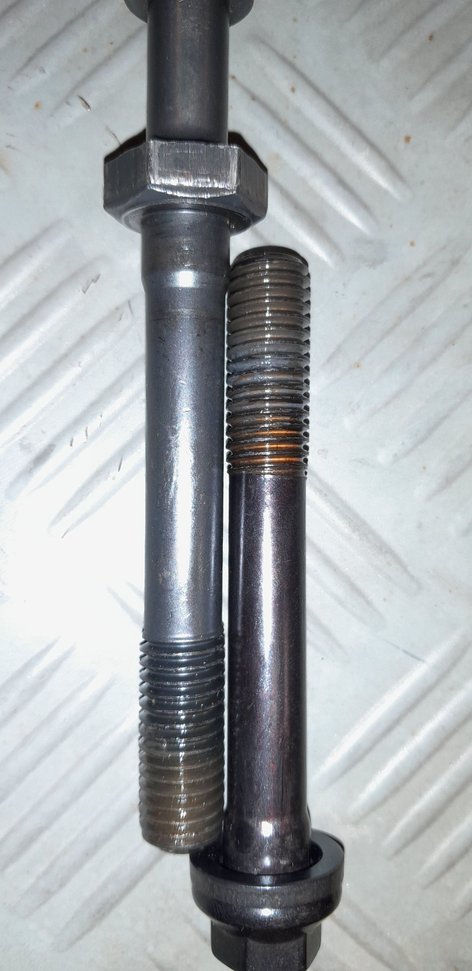

With milodon pan i cannot use the gm original main bolts, so i bought arp 135-5201 main bolts and found out that the arp bolts are 0.150" shorter compared to gm bolts, I quess this is not a problem? Arp only lists this kit for gen IV/gen V.

Starting to steer away from these arp bolts. How many threads should be engaged in the block? I know the old rule for depth is the thicknes of the bolt, but i am barely there with these.
https://cimg2.ibsrv.net/gimg/www.off...1bd359803b.jpg
Brad Christy 05-30-2024 04:15 PM
Jani,
Conventional wisdom holds that 1-1/2 X thread diameter will achieve maximum thread strength. Personally, I like as much as I can get, and have designed parts with 2-1/2 to 3 X thread diameter, just to make myself feel better about them. I haven't the foggiest on head bolts, but I'd think you'd want considerably more thread engagement than single thread diameter.
Thanks. Brad.
Sporl Performance 05-31-2024 06:00 AM
Put studs in.
JaniH 05-31-2024 08:33 AM
Originally Posted by Sporl Performance (Post 4899284)
Put studs in.
Do i need to line hone the mains then?
sutphen 30 06-01-2024 08:33 AM
you should
