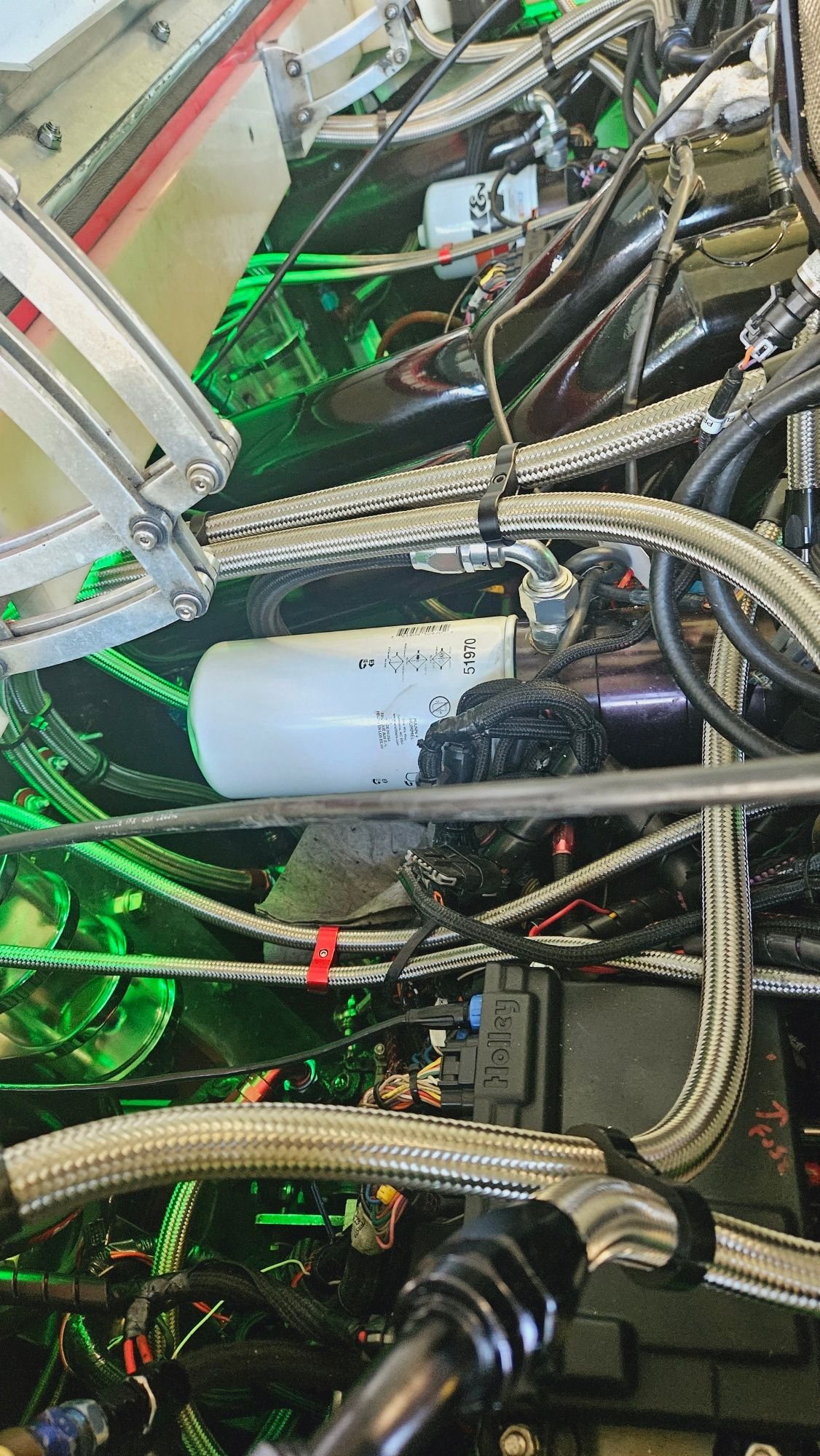

Last year I built a new 502 for my Baja, I still have a Mercruiser 35-866340K01 filter on it, is their a larger capacity filter I could run on it? Its a lake boat they does not see long hard blast at all so I might be overthinking this but figured I would see what you guys are running on the Mercruiser big blocks.

how big you want to go?
heres a 2qt filter oil filter
Just do a search for 13/16x16 oil filter and you'll get all kinds of listings. May be easier to go to NAPA and have the guys do a search for ya

Not sure just I thought the filter on it is kinda small for 509 Cid engine but maybe not. Im sure I am overthinking this.

If you want a 2qt with a bypass valve and anti drainback valve, then the Moroso 22461 is good.
If you want a 2qt without the bypass or anti drainback, then the AC Delco PF932 is good.
Both filters are in the high 20s for micron rating and flow well.
If your filter is mounted with the flange down, then I'd go with a filter that has an anti drainback.
