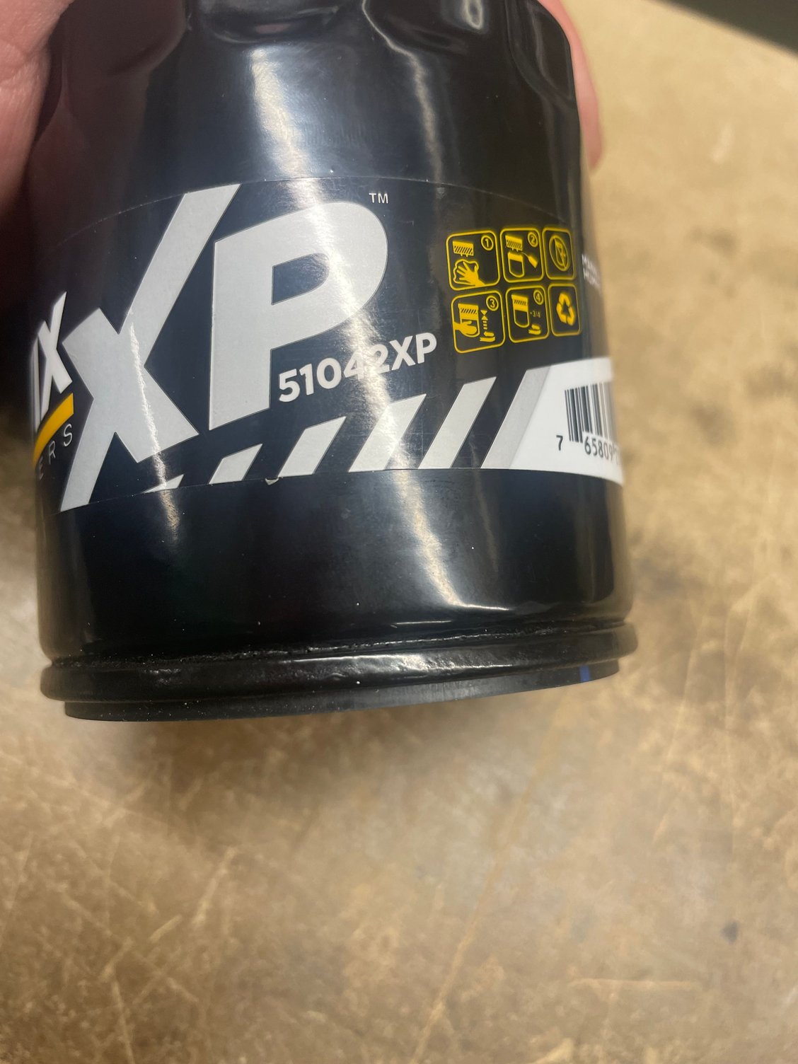

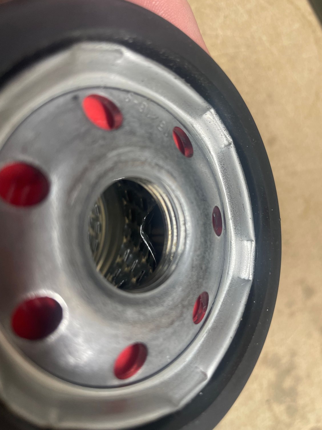

I use a lot of filters. For work and myself. Mostly Wix.
Here's a concerning one from a few weeks ago.
Look inside. It’s a new, not installed one.
Maybe time to go with a changable element style filter.
That is rough.
nice catch on that one quality control does not exist anymore

SB, where was that filter made? It seems like the ones i have that are US made all have the black seals in them...yours has red....my buddy that had the Napa Gold from China had the red seal in it as well....

yes they all have the same thread size for the filter 13/16-16 the only difference is the height of the filter. Im not sure if they put the small ones on because of some bean counter figured its the smallest cheapest they can fit on and still get away with enough filtration or what.

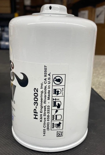

I picked up a K&N HP3002 for mine. Any way to tell where it's made, if they might be made "elsewhere"?
Thanks. Brad.

Wally,
Thanks. Brad.
Delete. Didn't see 87Mirage's post before typing.
Box says "Made in Mexico", to answer my own question from above.
Thanks. Brad.
