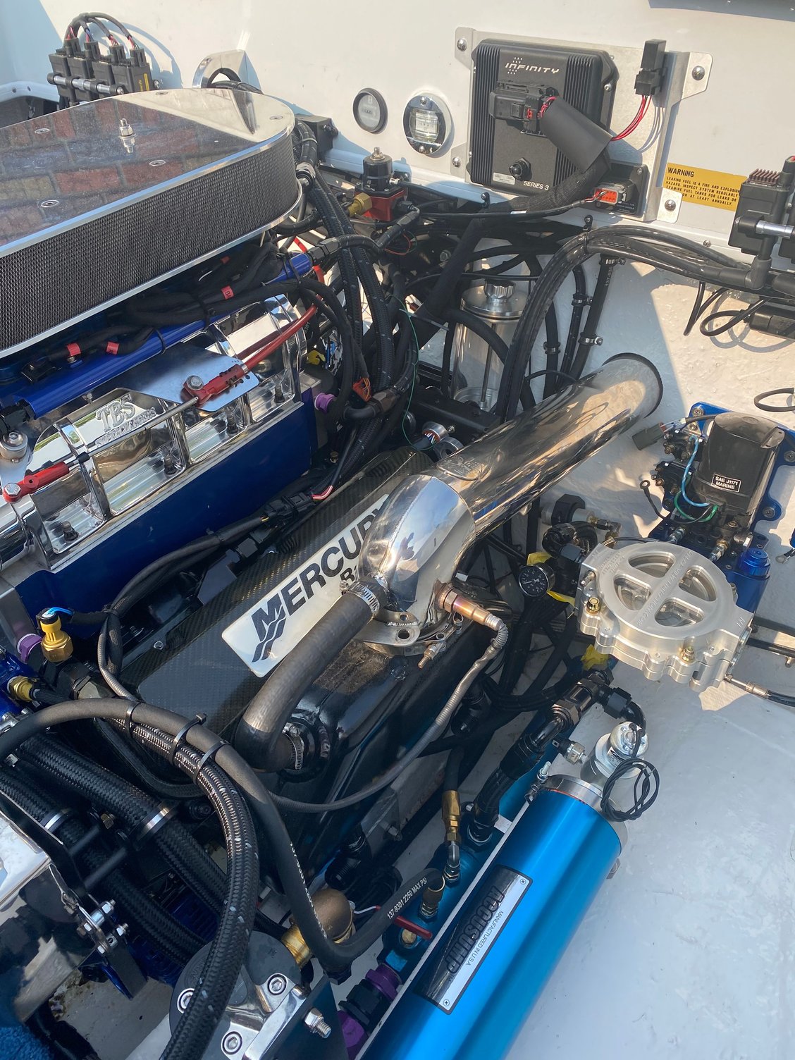

I run a clearview 60 micron same as wixR which lets me check filter when I want to see if it has anything concerning in it, with oil changes every 25h or so. All -12AN lines and an accusump to on start up and god forbid an dips in oil pressure underway.
