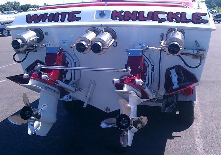

I have CMI Etops that are dry and dump water right at the end of the tails outside the transom. The water really doesn't mix wit the exhaust. I have switchable mufflers on the ends of the tails. Closing them takes a lot of bark off the exhaust sound at idle and slow cruise speeds. I also close the mufflers when coming off plane to prevent reversion from my own wake

I have seen it done a couple ways, one is individual dumps for each pipe, my buddy (RIP) used to like to put them out the starboard side so you could take a quick look and see the water dump.
Then there is just a small hole in the bottom of each pipe so the last bit of water will run out when the motors are shut off and to keep some cooling going to the very end.
Others put dumps on the transom side and just aim away from the end of the pipes. Still need the little drain on the bottom, we boat in salt here.
