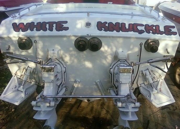

And this is dry to the tip on my TRS tails. 1" water pipes at the end.
Rookie is offline
Old 05-30-2024 | 06:28 AM
Joined: Jun 2022
Posts: 641
Likes: 445
From: Tullahoma Tennessee
Default I see
this photo confirms my suspicions even more that my holes are TRS in the transom
