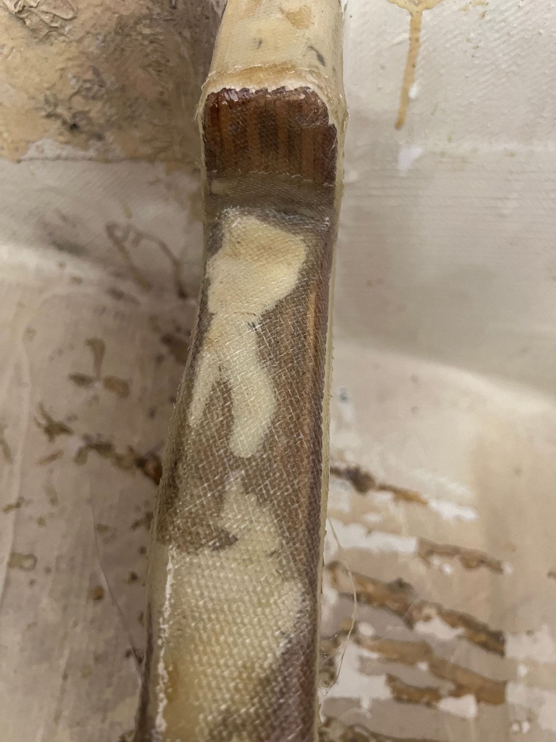

I relocated the shift plate to the transom; starboard side. Like I said, nothing ON the engine that doesn’t need to be.
I cleaned up the horrid glass job as best I could. It looks like they sealed off the wood well enough before completely clusterfarqinng the glass job, so that’s good. I gave up on cleaning up the overflow of epoxy/resin. I’m tired of cleaning up the dust. It’s under the PeoCharger. Nobody’s ever going to see it. I will glass it over properly in the morning. I never expected to be doing glass work during an engine rebuild, but here we are….
Thanks.
That would drive me nuts. Get some 40 grit and smooth that chit out before you glass over it.
tomorrow is a new day and winter has barely started.
For you anyway, me I am going to jump in the pool.
Wildman,
It bugs me, too, trust me. But it’s under the ProCharger, and on the inside of the stringer. The outside is much better, even if still still not perfect. I’m taking solace in the fact that nobody will ever see it. Even if they try. It has also occurred to me that we’ve owned the boat for three years, enjoyed the Hell out of the boat, and didn’t even know it was there..
If I get everything else wrapped up and we’re not yet ready to drop the engine back in, I might reconsider.
Thanks. Brad

Got the ProCharger clearance cutout glasses in today. I also took Wildman’s advice and cleaned up some of that resin overdrip mess. It doesn’t really look like it, and it’s not perfect by a long shot, but it’s WAY better than it was.

Why are you using epoxy vs polyester or vinyl ester resin for that repair?
Rookie is offline
Rookie,
Two basic reasons:
1) Materials on hand.
2) Familiar territory.
I guess my question is, "Why not?" It works easily, wets out great, adheres very well, soaks into raw wood wonderfully, and, by my observation, cures harder, stronger and more chemically resistant than PE or VE resin (at least, WestSystems does). I can tell you that literally nobody who builds high-end, high performance composite model boats (as opposed to wood) uses anything but epoxy. There is an ongoing and everlasting debate over WHICH epoxy system to use, but they ALL use epoxy.
I obviously have no professional experience in fiberglass work, and there might be a valid reason PE and/or VE is still used in full-sized boat industry. But I used what I had and what I was familiar with, and I have full confidence that the repair will outlast me. I used WestSystems to seal up the freshly exposed raw wood when I did the pop-up cleats and when I used the PVC pipe trick and reattached the depth finder transducer, and both worked out well. In this case.
I wasn't so much interested in how it was going to look. It was pretty much too late for that. I only sought to seal up the wood and get rid of the cobbed up mess they left me with when whoever did it to begin with cobbed it up.
Thanks. Brad.
