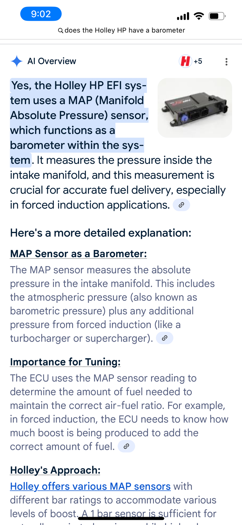

It might be a matter of semantics, but, it does, in fact, account for air density changes, like a barometer.
Thanks. Brad.
