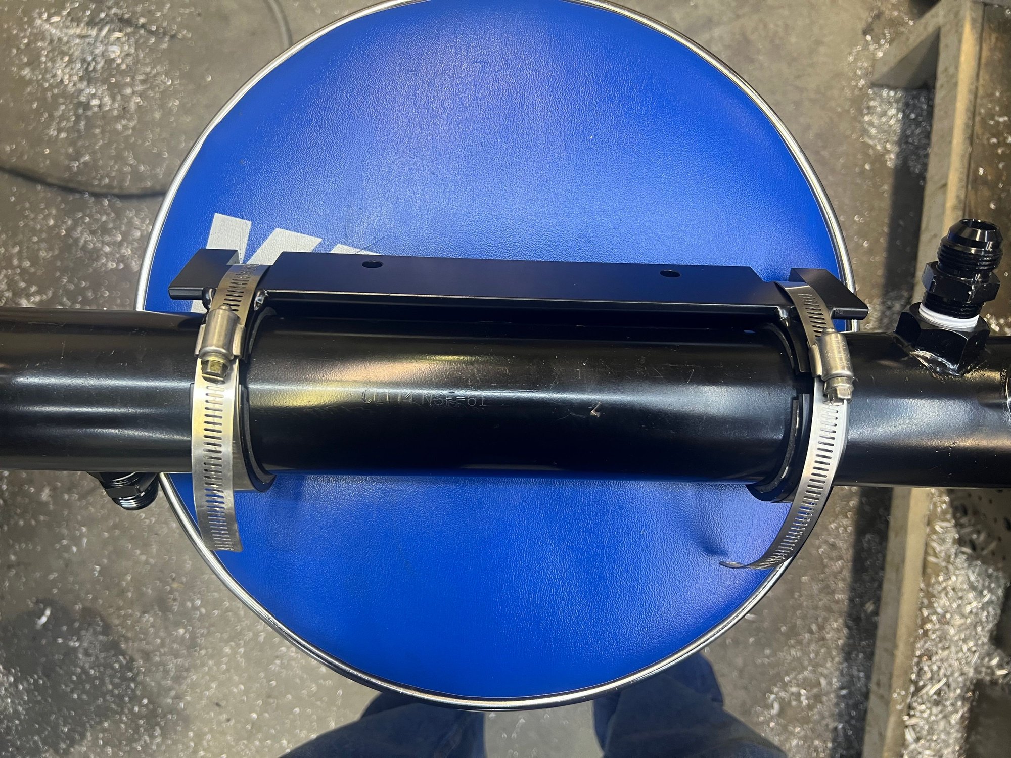

I'd run your steering through its full range and make sure it doesn't hit... that looks awefully close..
That aside, sweet setup, I like it! Might also want to put a foam pad between the HE and the angle bracket too to avoid any vibration from wearing through the shell.

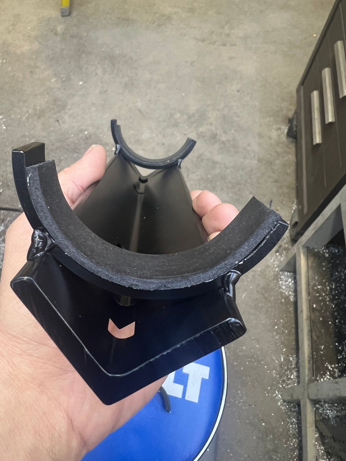

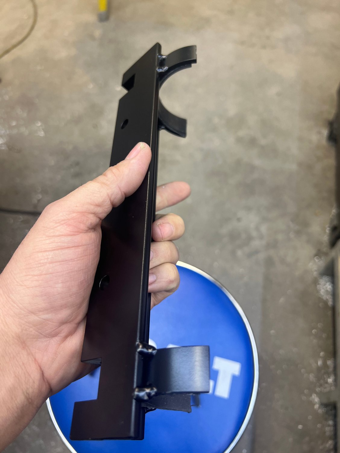

Got some peel-n-stick neoprene rubber, measured it, measured the cooler, did the math, turned and bored a tube, parted off two rings, split them, had the welding done, painted, applied the rubber, and clamped it all together. We’ll sort out orientation and hose clamps at assembly. For right now, I’m allowing the adhesive backing fully bond.Thanks. Brad.
