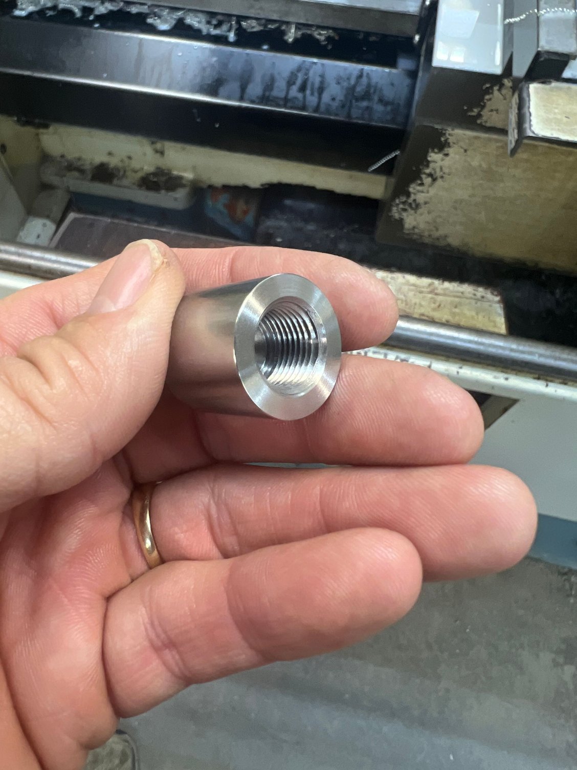

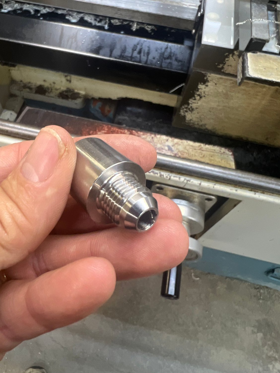

Made a union adapter for the PS line for to be looped together during the dyno session. I’ve since machined a hex on it for a wrench. The threads are M14X1.25 for anybody interested.

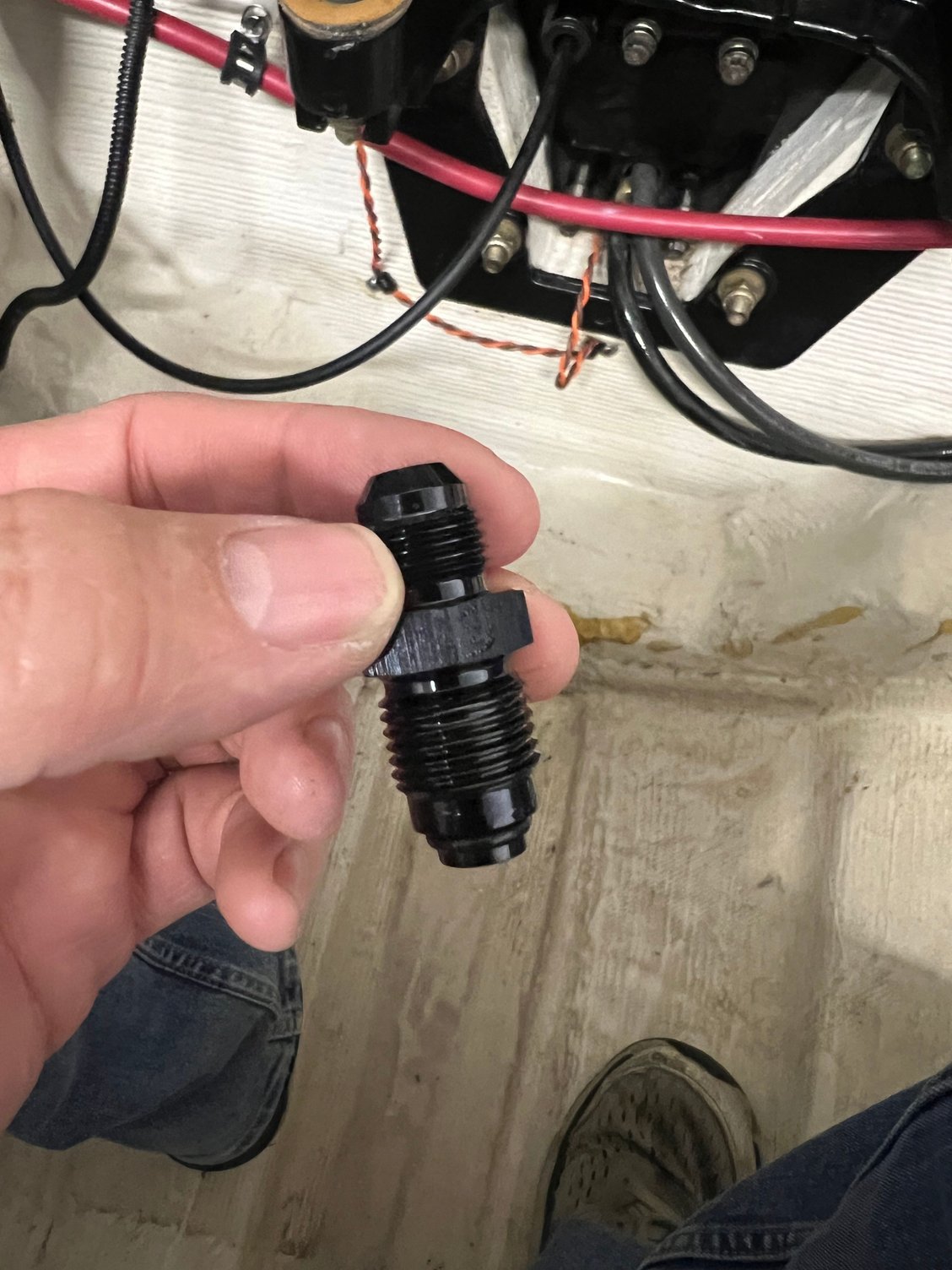

Found a cool M16X1.5 to 6AN adapter for the PS return line that has to be remade as a result of repurposing the OEM oil cooler as the PS cooler. I had intended to remake the high pressure side, but have since decided it’s not worth the effort. It seems the connections on both ends are more work than they are worth. The hose is intact and looks to be in pretty good shape. I’m just gonna leave the unbroken unbroken.
