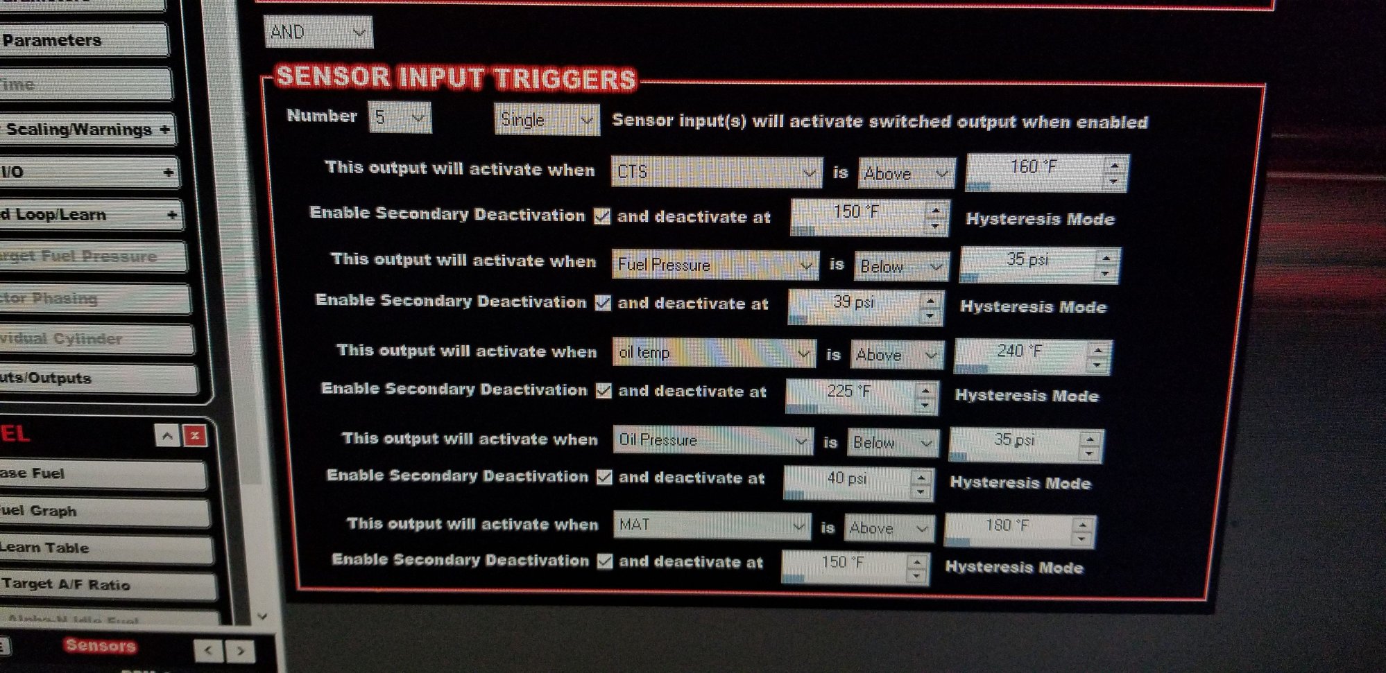

Originally Posted by sutphen 30
I saw a show on engine masters where they were looking at IAT,they basically said it didn't matter to power,and were at 165-170°.just food for thought
so in my personal experience dynoing things to the "limit" of a given octane, usually around here on 93, IAT much above 120 pushes alot of stuff into detonation, same with afrs. Heres a example : I had a whippled 509 on dyno with tailpipe afrs around 11.5 in what I call "hard boost", 8, 9 psi. Was making around 800 hp, similar tq. This engine was leaving and going quite a distance away which makes in boat tuning more difficult so since mefi is blind speed density and thats what it had, I usually tiune at 50 to 60 psi and tune idle, part throttle slightly rich. This allows owner to make a "global" change in boat by simply lowering fuel pressure IF it becomes richer in boat which often happens. so I was about done tuning and reviewed my fuel pressure which was only at 40 psi, I had meant to increse it earlier and hadn't. So I increased fuel pressure to 55 from 40, about "1 bar", that usually increases fuel flow 12.5% on a typical injector. So I mathematically re-scalled the whole tune, when I repulled it the tailpipe afrs were NOT at the 11.5 but closer to 12.0, 12.2. I had pulled TOO much out trying to account for dead band/injector latency. This engine previously had not one hint of KR, at 12,0, 12.2 it not only had 2-3 degrees of KR but IF I stayed in it, it went into knock hysteresis and had to pull 7 or 8 degrees. So I worked on the tune to get afrs BACK where they were with new fuel pressure. At 11.7, 11.8 the KR was gone, I like to have a ;little safety margin so getting it back to 11.5 gave me a little safety factor. This last quip was sorta in response to a phone call from brad while tuning the other day.
IAT: I have also seen where at 140, 150 IAT where I started seeing KR on a long pull. I often use a 45 gallon supply of water and a circ pump when supply water to a innercooler, I try to temper water to a temp close to what customer would see, ie, he lives where waters 85 degrees vs 70, and will blend in water to hold that innercooler supply temp. I have done back to back pulls and allowed supply temp to reach point the IAT at intake was getting in that 140, 150 range and started picking up kr so I like to see no more then 130. In automotive world with a air to air innercooler those IATS are almost un-obtainable so much more timing is pulled and fuel added.
So If I were you brad I would say in yoiur holley to pull 1 degree at 130 and progress from there exponentially since you dont have a working knock sensor. You can also use a fuel modifier table to start adding PW vs IAT after 130 since its so easy to do in a holley. By 180 Id be adding 15% and pulling at least 8 degrees of timing in case your flow to innercooler has a issue, to point boat will start slowing down where you notice and it will protect it from detonation. The ability to quickly and easily build "saftety" into your iat and ECT tables in a holley is a great feature, Smitty

I had safeties set up... if any of those limits hit it would limit rpm to 2500.. like a Guardian mode
Smitty,
Thanks for the call-back the other day. The numbers the tuner was throwing at me were leaner than the builder had mentioned throughout our conversations, and the tuner was more than willing to accept input from someone with more marine tuning experience.
Can I get a glossary of acronyms? A few of them I know. A few I have guesses....
Thanks. Brad.

Smitty,
Thanks. Brad.
KR= knock retard
ECT; engine coolant temp
PW: pulse width or "ms" milliseconds of injector firing/triggering in a fuel table
