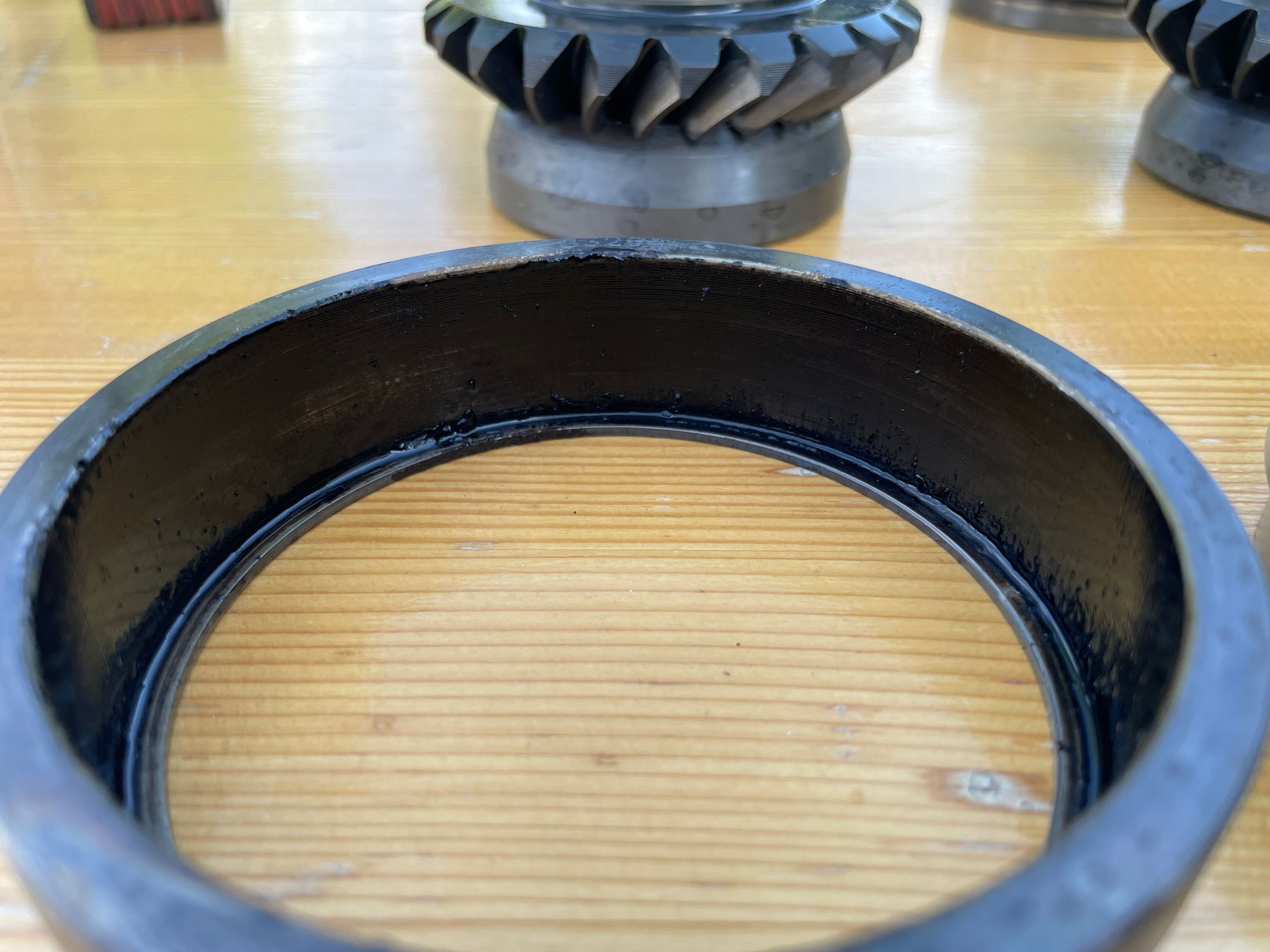

- Clean the cups without taking the friction layer off

I could see that the upper and lower gear cups moved closer to each other causing the gears to touch the upper gear housing.
So took everything apart again and say that both cups had been pushed out of the bearings slightly.
Strange since I tightened the nut once before to 120 nm without any prolems.

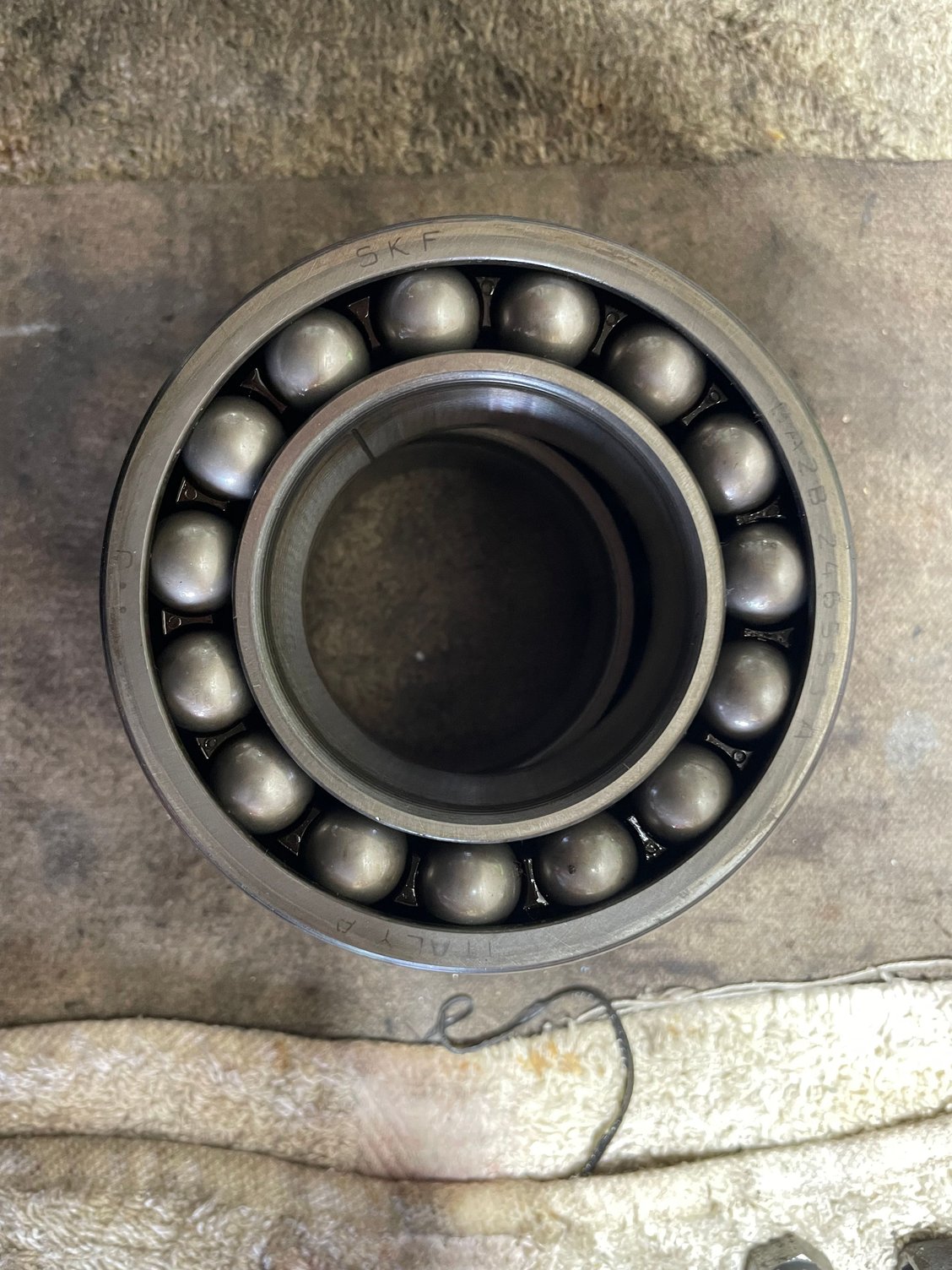

Anyway, this made me look at the bearings more. The upper one already made some harsh sounds.
I believe it was the beginning of being work out.

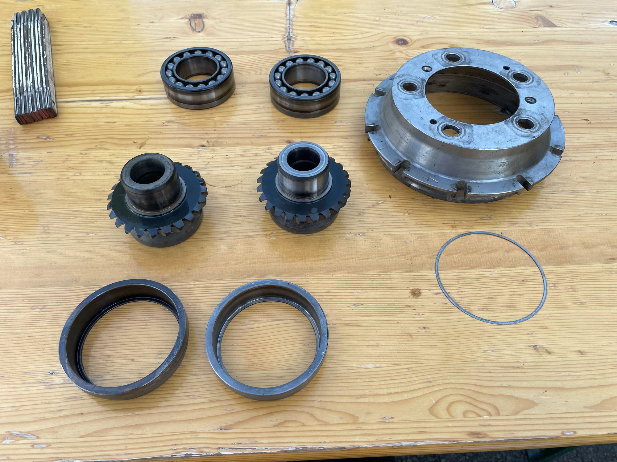

So, instead of assembling it I decided to take it apart further, measure and calculate the correct shims and replace the upper and lower bearing.
Life never gets boring as they say...

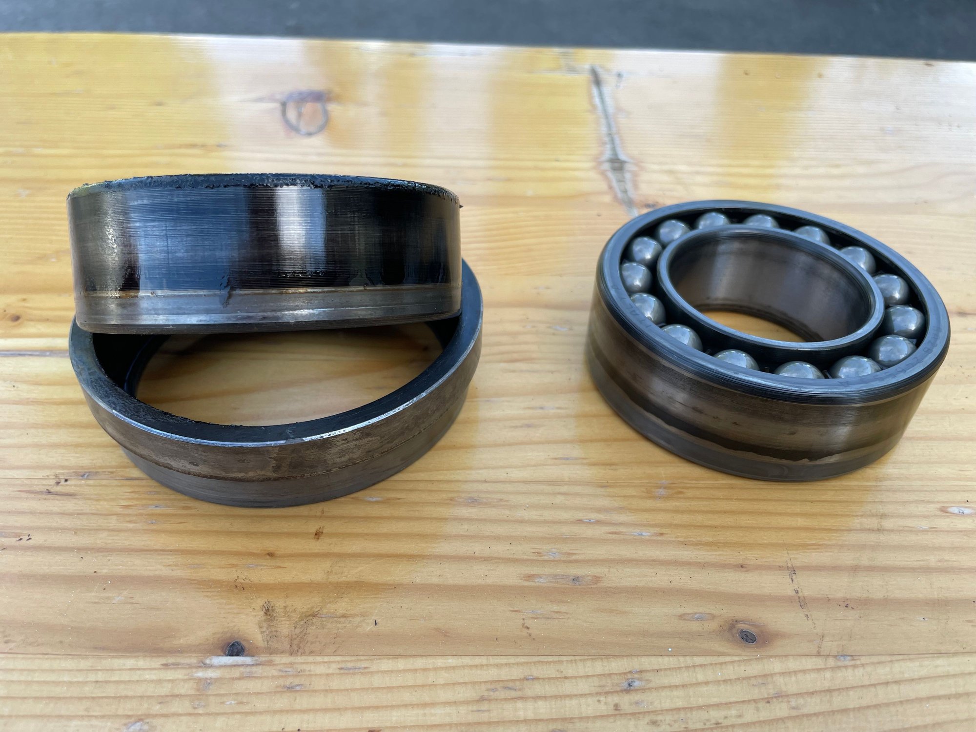

When i took the bearings out I could see some change in colour of the out bearing rings as well as some crust.
Either I casued it when I used the wrong oil or this was caused by some incident before I bought the boat.
I believe that it was once run with not enough oil before I got the boat. This way I didn't feel too bad for having used the wrong oil... lol.

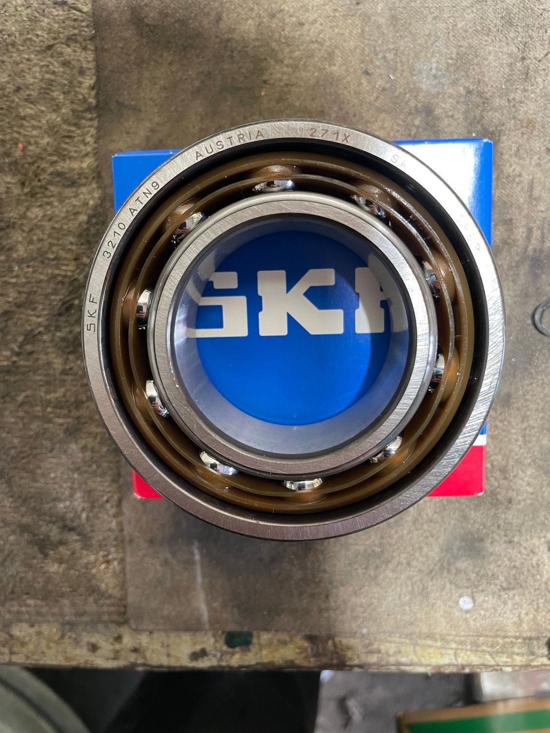

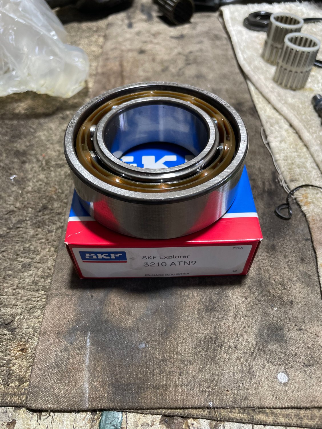

Volvo Penta bearing part number: 853542 (SKF bearing)
SKF part number (not in production anymore): BA2B 246553A (50x90x30.2 - normal precision - plastic cage)
SKF part number of equivalent bearing: 3210 ATN9 (50x90x30.2 - normal precision - plastic cage)
The 3210 bearing is the only bearing SKF produces which matches the dimensions required.
I checked the data sheet and think that 51kN radial dynamic load is gonna be enough, not that I have anther choice regardless.
Both bearings share a contact angle of 30°.
The SKF Explorer 3210 bearing is available with a plastic and metal cage. I have gone for plastic cage.
When I looked up the Volvo Penta PN, the price per bearing was 400€ each.
Recmar's SKF equivalent is 100€ per bearing.
I got the SKF Explorer 3210 ATN9 bearing from a ball bearing shop for 50€ each.
Maybe this information helps someone who needs to replace the bearings of the DP stern drive.
