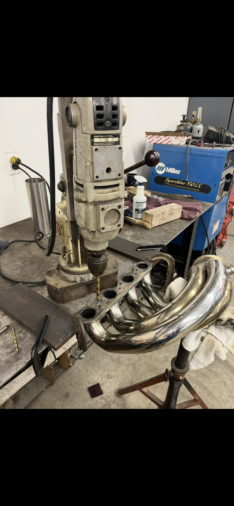

I have done it and it worked but getting the bolts in kinda sucked. Wasn’t a quick way of clamping to my mill so I used a mag drill. Worked really good.

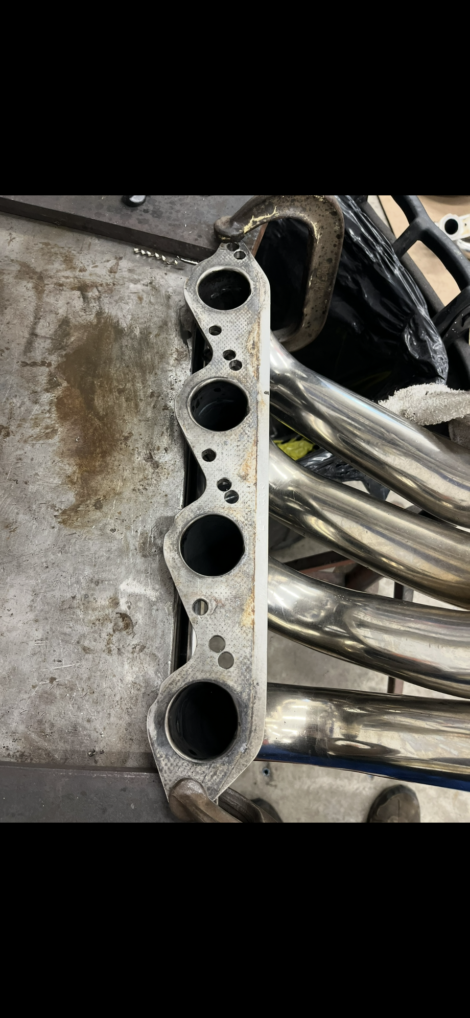

These started as 525's that I drilled a standard pattern in so they can be used on either head on the dyno. Either way, yes it can be done and not a tough job.
those headers look so familar, good job buddie!
