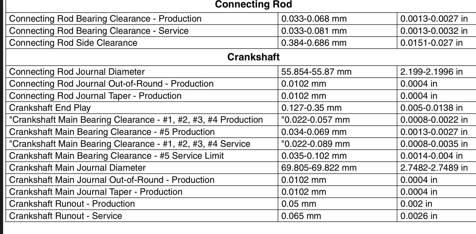

That's spec? Seems tight to me, my rods aren't that tight.
I thought at least 0.001"/in
My measurements were vertical. At the left and right 45 degrees there was on average 1-1.5 thousanths
more.
VP shop manual:

How did you measure the main bearing clearances? Very tight for a marine BBC.

Used a dial bore and micrometer.

Darin Morgan Quote:
If you run your main/rod bearings too tight, everyone will know. If you run them a bit loose, no one will know.
Engine oil cools the bearings. High pressure low flow = less cooling. MED high pressure high flow= lots of cooling. Tighter bearings restrict oil flow.
BMW perf V8 engines are running 0.0015" as a max tolerance on their rod bearings. They're spinning bearings. Some guys have set up shop just to do rod bearings on these before they have an issue.
M67 fragmentation grenade has a 4.5sec fuse. The spec is 4-5sec.
If you run that tight, all the machining and tolerances of everything else need to be in spec. Tolerance stacking to failure is an issue.

your machine shop bored block .030 over and I assumed decked block BUT left the cam bearings in, never removed them? What did they wash the block out with, doesn't look hot tanked, personally I would NEVER have any machining done to a block and leave used cam bearings in while machining ( metal can get trapped in feeds).
Your main bearing clearances are very tight, you may very well be fine at those specs IF crank is perfectly round BUT do NOT consider running a high volume pump of ANY SORT with those clearances or you will have crazy high oil pressure.
