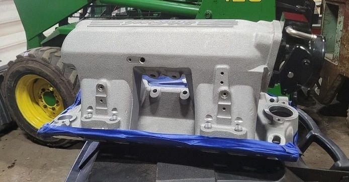

That's right...the Ramjet GM crate engines. The 350 version is more like a TPIS Mini ram. Solution from the GM TPI system.
The BBC 502 Ramjet intake looks interesting, but it appears to have some sharp turns into the head ports.
The Holley FI tunnel ram style FI intake has a better intake port entry angle.
The benefit of FI BBC intakes like these...is the underhood clearance.
Ramjet 350

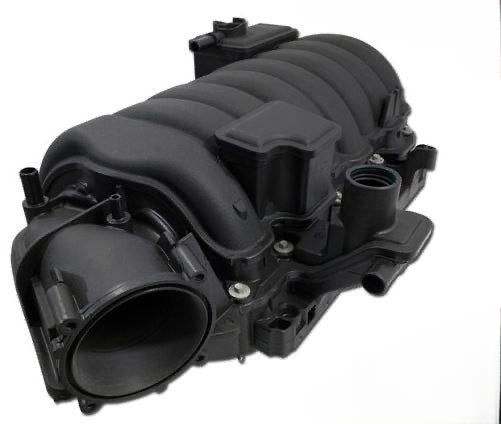

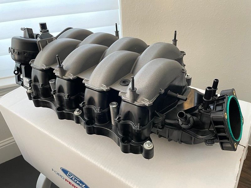

I started looking at the modern OEM intake designs for the Chevrolet LS, Ford Coyote, and Mopar Gen 3 Hemi.
They all have long ports curved at over 180°, all of them.
The closest thing to those designs is the ASM/Mercury 500/525.
I refuse to believe that what works for Mercury/Chevy/Ford/Mopar won't work for me, BBC 454.....
The intake design Ligenfelter developed for the C4 Corvette is conceptually very similar to the ASM/Mercury design as well...

Coyote Mustang 2018
Mopar SRT 6.4L

Coyote Mustang 2018
Mopar SRT 6.4L
