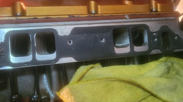

My floors are raised so port height is 2.100". Jim only raises the floors and does not touch the port ceiling. I add enough epoxy so the port height is about 1.900" and blended about 2.500" up the runner. I just try to give a nice transition to enter Jim's head port.
Mismatch
1.900" fill
Prototype Dart Pro1 head

Rookie,
I think a small shear line at the bottom where the head a a bit higher won't hurt flow that much, if at all...but the fuel droplets get a shear point to atomize and get into the airstream for the short side to draw them into the valve venturi. Are you using Splash Zone?

Originally Posted by Tartilla
Rookie,
Nice work by the way.
Thanks,
What's Splash Zone?
Edit... No, I use KBS Coating NuMetal Epoxy puddy.
