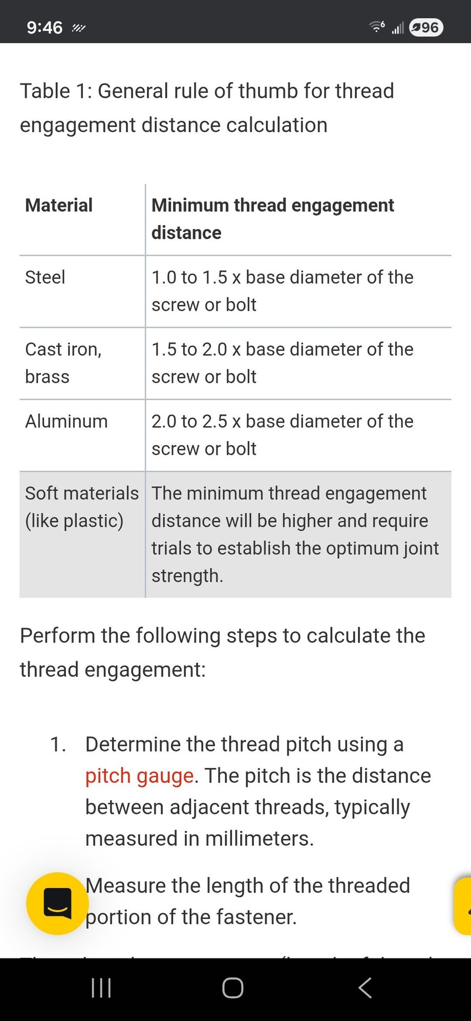

LakeBoat,
That's understandable. I could add .100" spacers under the studs, which would lose me 1.4 base threads, but gain me 2 polylock threads. The base threads of the rocker studs is .750" long (advertised), minus a .050" spacer, minus the guide plate thickness of .087", leaves .613" of base thread engagement. I lose 2/3 of a base thread engagement, but gain a full thread of polylock engagement. Sounds like a reasonable compromise. What says the brain trust?

powerboatr 11-20-2025 09:36 AM
Originally Posted by Brad Christy (Post 4938880)
LakeBoat,
Thanks. Brad.
1 to 1.5 threads emerging from top of poly lock nut is adequate. 2 or more is better
but once threads emerge past the locking nut.
the nut is doing its job
i have had to believe engineers
On aircraft that specified bolt at set length with washer and nut...which results in one thread poking out of top of nut...they held
but still gives me the wilies
Base thread from .750 to .613 is noticeable
thats what 2.5 threads ?
Correct spacer that supports etc. Maybe an option
But as an aircraft engine guy..it would bother me long term.
Build it
Mark the studs and nuts
Check afyer 10 hrs then again at 20
Then maybe 50 hrs. To mske sure all the parties are happy and not loosening or trying to pull the threads out of the head
Are your heads cast iron or alum.
Your plan seems sound on paper
bolts are designed for full thread engagement into head.. but shims were made for hmmm adjustment 😁😬😬
below is a general rule on engagement of threads
https://cimg4.ibsrv.net/gimg/www.off...65c43c0202.jpg

Brad Christy 11-20-2025 03:09 PM

PowerBoatr,
Conventional wisdom actually says 1.5XØ is maximum thread strength, which would be .656" for a 7/16" thread. With the .087" thick guide plates under the rocker studs, I'm already at .663". I was actually thinking more along the lines of a .050" spacer, which would put the thread engagement at .613", so not that much of a sacrifice. That said... I've pretty much decided to just go with what's here, as it's been working fine. I've set up the rockers with the pushrods that were in the engine and the new cam, and the rocker/valve tip engagement ain't hateful, even if less than ideal.
