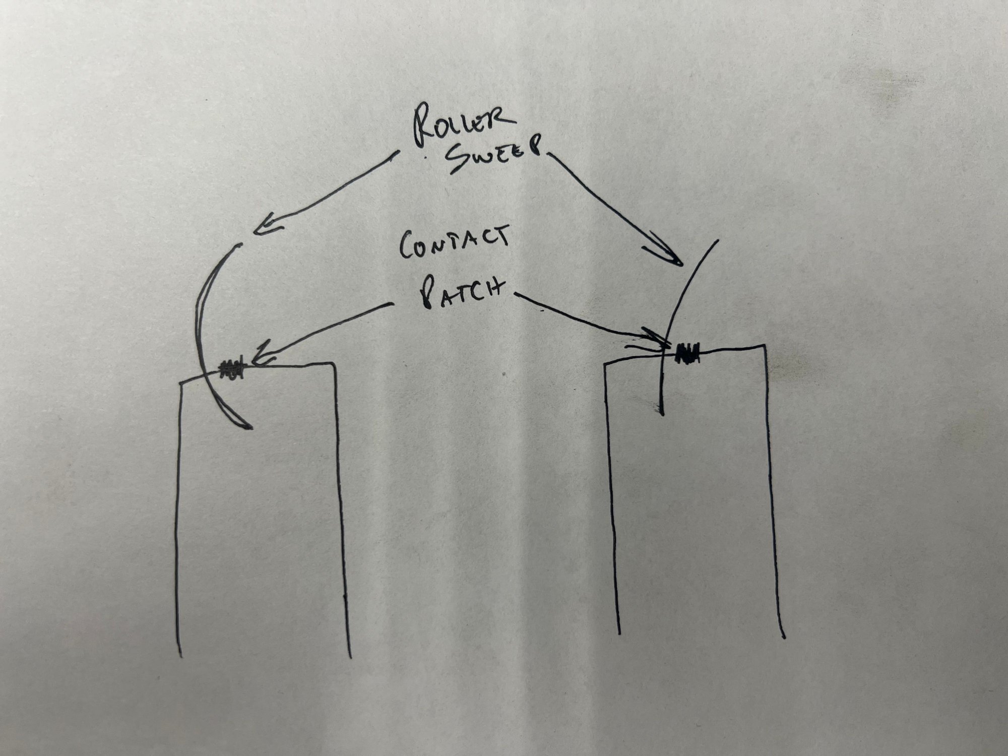

Guys,
I know there are a lot of opinions on this….
Doing this cam swap, and addressing the pushrod length setup.
Which is better?
Thanks. Brad.

I’ve done a ton of YouTubing, albeit I haven’t come across Powell (I’m aware of him). So far, all I’ve seen/heard/read is that you want the left image sweep with the right image contact patch. Unfortunately, with stud mount rockers, that’s not always possible. Sometimes, you just have to choose one over the other. So I’m asking the brain trust their druthers.

This is how i do it, makes sense to me. Keep calm guys 😁

Having The sweep in The center of The valve tip IS not so inportant as The ammount of The sweep, The less The better.

I feel differently than most. I always try to get the pattern centered. I would rather give up a little lift to have the valve pushed down as straight as possible. But every time it has also ended up with the narrowest pattern. One thing to take note of is that different rocker manufacturers will give different results. You can put a Brand A 1.7 Big Block rocker on a head and it can be almost impossible to get a decent pattern. Take it off and put a Brand B rocker on and it will be perfect. And it can vary from one head manufacturer to another
You asked for opinions . . . . .

Scott Foxwell from Straub Technologies gives the best set up in this YouTube video:
As to where the sweep cones out on the valve, be it centered or inside/outside a little doesn't matter. Ed Iskendarian put it best when he said, " thats why theres a roller on the rocker tip." Just so it's not coming off at one extreme of the sweep you'll be just fine.
