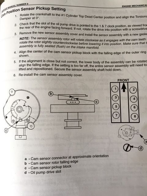

if I am reading this right the original engine was a 305 and now it is a 350 but is using all the parts from the 305 except block and heads. this also appears to be a flat cap distributor motor. if so is the dist in correctly. you set it to TDC of #1 and then install the dist with the rotor pointed to the mark on the body and lock it down as the ecm handles everything else. trying to make sure what parts are used as there was a time where some components switched the wiring. I know on certain MAP sensors they swapped the + and - wire location at a certain point depending on what MAP sensor you have but not sure if that happened with the TPS as well.

you talking about this distributor set up,
