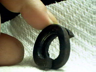

split washer goes on top of gimbal inner plate, tailstock sits on top of this washer. Leather washer fits around outside of split washer

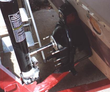

alignment tool in place, raise/lower front of engine for alignment.
