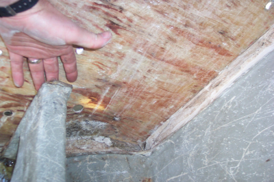

I am mostly done with my project. Here is what I did...
I cut the inner glass at the hullsides and at the bottom of the hull bottom around the stringers. I then cut the stingers at a 45 degree angle ending at the transom. I cut the sringers for two reasons. One, I wanted to put the new plywood in as one piece. Second, I wanted to be sure that the wood in the stringers was not rotten.
Anyway, the old wood came out very easy. Most of it came out with my hands. The remainder I used a large wood chisel and cleaned the outer glass of all the old wood. I did the same thing with the inner glass, too.
When Fountain built the boat, they laid the hull up and installed the plywood as it was in the mold. After they pulled the mold, the deck was installed ie:shoebox. I decided to build my new transom higher, to tie into the deck. I did this because Fountain glasses the hull/deck joint all around the perimeter of the boat, but with the inner liner removed the joint was only rivited (not the most rigid).
I used cardboard from Charlotte Appliance (big fridge container) for my template. My new template would be about four inches higher than the original wood.
I was ready to cut my plywood.
I used marine grade plywood. I wasn't going to, but it is guaranteed to be "void free", plus the glue they use is much more durable.
I cut the new wood beveling the edges to fit the angle of the deck. I was going to laminate the two pieces of wood before putting it in the boat, in the end I installed it in stages.
I used West Systems epoxy for bonding. I found their product to very user friendly.
So, I used their epoxy and mixed per recommendations (get the pumps). After I wet the surfaces, I mixed a paste with their 404 powder glue. I put it on with a trowel, just like you were going to lay tile. I put the wood in place.
I made a clamping system using 2 by 4's and 2 by 6's. I cut 2 by 4's to fit inside of the boat that went to the hulsides ant the 2 by 6's extended beyond the hullsides. I through bolted the wood. I used three different clamping systems using the holes of the outdrives, exhaust, and k-planes. The bolt holes for the k-planes located the new wood.
I did this with each piece of wood and finally the inner glass. I used the thickened paste to fill voids and around edges (like mud for drywall).
I have to put glass mat around the edges for strength, to tie the new wood in. Then some finnish work and paint.
This is a job that anyone could do. It just takes some time. If anyone has questions please let me know. I have taken the last of the pics and I'll post 'em after the weekend.
