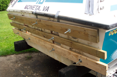

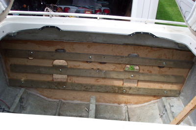

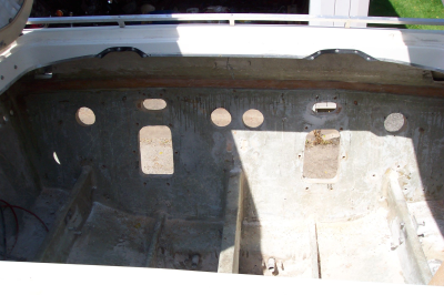

Construction is finnished. It came out better than I expected it to. I'm nearly done painting the engine bay and the transom exterior. I'll do pics after the Holiday...
#56
Steve,
They are. I will drop them off at the dyno next week. Then install them and work out the bugs with the boat. Every step has taken longer than I anticipated. Doing it myself has saved a ton of money and I get a sense of satisfaction BUT, if I paid to have it done I'd be in the water. Oh well...
