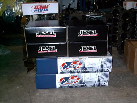

Some of the many new parts arrive.

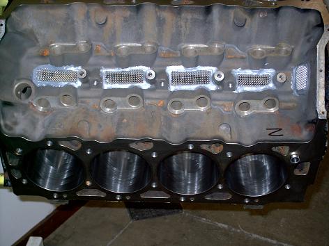

Screens in place

Default Re: Rebuilt engines in progress
How did he get the rust out of the water passages?
They did mine with stainless shot blast cabnet that turns. It did not do a good job i have heard of a acid wash that gets all of it.
Thanks
Rob
Strip Poker 388 is offline
Old 12-06-2004 | 05:52 PM
The Menace's Avatar
Joined: Nov 2002
Posts: 3,029
From: Bonita Springs, Florida
We haven't figured the rust part out yet. I knew the port engine was apart before but the starboard was to have never been touched. It had a different set of gaskets so we figured it has been apart.
Did not clean out the passages. According to my buddy Dave it is actually better to leave it in there. He said it forms a coating which actually inhibits additional rusting.
