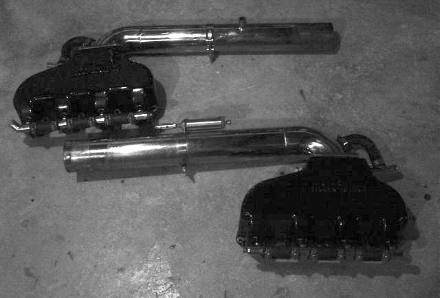

Also, what is the peice on the manafold that runs across the bottom of the manafold in the picture attached? Is this the hose supplying the water? Thanks
Yes , it comes from the t-stat housing to this hose that distributes it to each exhaust port
