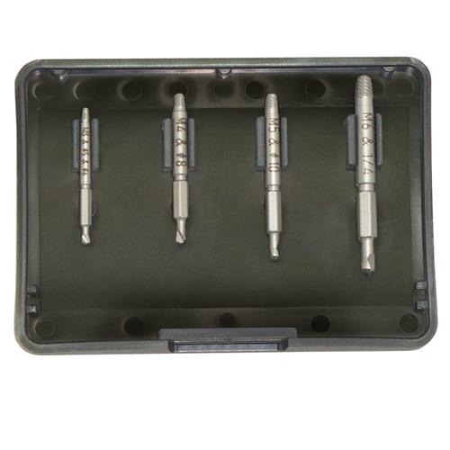

I had quiet a few broken stainless bolts in my trim tabs and my old TRS Gimbals.
Try the Craftsman Drill-Out or Micro Drill-Out. They work allot better than standard extractor. The left handed drill portion of the things are very hard and will cut into the stainless VERY well.
Make sure you center punch it carefully and take your time drilling. If they break they usually break leaving enough of the extractor sticking out so that you can remove the broken extractor. They don't stay stuck in the bolt like regular easy outs.

The set you need is part #52155

thanks a bunch Zanie!
these gotta work better then an easyout.

I hate to say it but............................
read the instructions.
Also, take your time.
