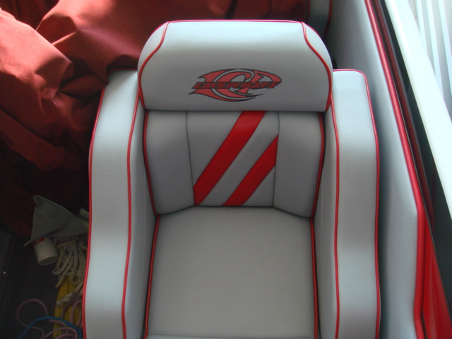

TV - Here are some pict of the interior of my 20.8 Sebring.
This was done three years ago By Ross at designer marine/Lavey.
Have you thought about external steering?
note : There is a strange compression artifact from my camera that causes the dash to look funky in some areas, these areas are smooth as a babys bottom.
