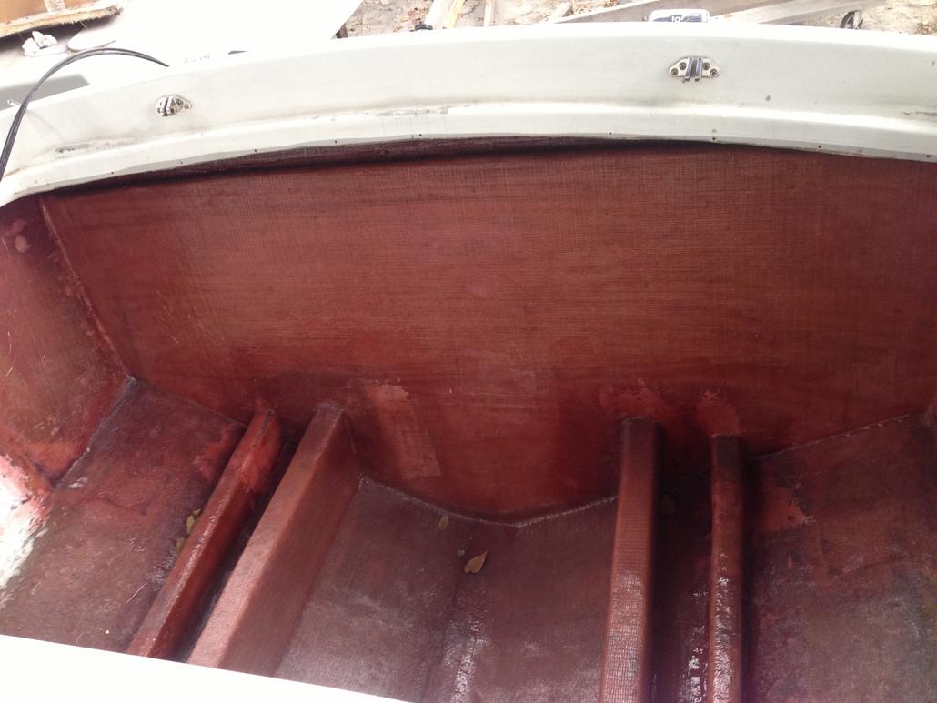

Transom is done and so are the stringers! Passed by to see pepe this morning and he's going to rent me the template and I'm going to be cutting the hole myself. More pics as I move along, I will probably be sanding the sides tmm as soon as I take off the rub rail

Transom looks great z!

Nice Job on the transom!!!
