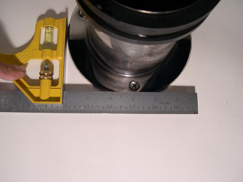

OK here is the low down on my install. The mufflers I took off had a total outside diameter of 5 1/2" see picture 1
and the new tips from Eddie Marine were 4"....BUT they have a 3/4" flange all the way around making the overall 6" see picture 2
and as for what is inside see the rest of the pics on the next post.
I hope this helps.
