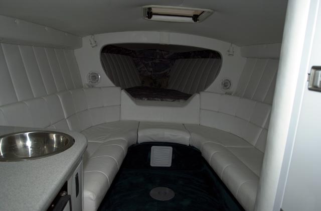

I moved my hot water to under the seat (no room in the engine compartment) it fit well and was easy to mount. If you have the engines out there is room under the bench but harde to get at if you have problems. Normally the water tank is under the port side extending from the engine bulkhead to almost the bolster seat.
I have a cruse air 5,000 BTU system in my PQ it was installed under the center cushion in the u-bench in the main cabin see picture. It has two outlets and works pretty well. The seawater pump is mounted in the engine compartment and the intake is in the bottom of the hull. The water dumps out beside the sink drain.
